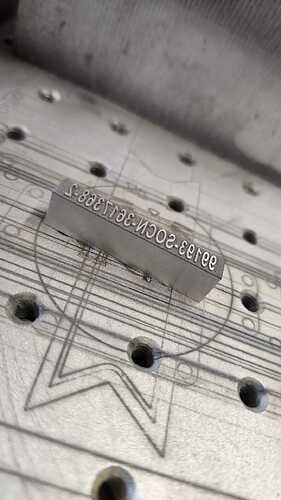

I do have a 50W fibre laser and I used it many times to engrave logos and cavity numbers on P20 steel moulding tools (I believe P20 is 1.2311). also used on copper for electrodes, and deep engravings on aluminium tools (7075, 2014T6 and 5083). Usually for logos and cavity numbers framing is a good way of positioning if there are some reference points around the engraving area.
in the image is an insert in 7075 aluminium 0.4 deep
those are on P20, 0.3 deep

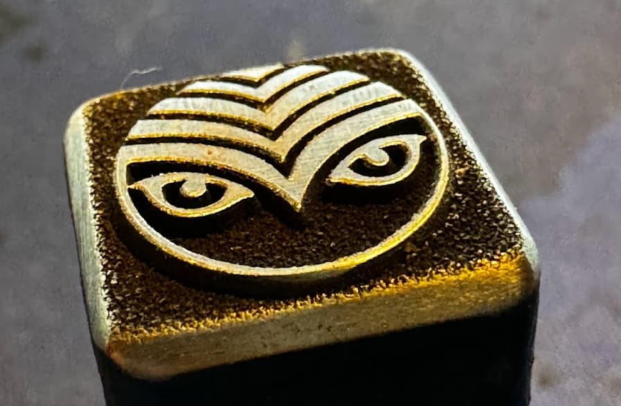

I’ve had very good luck etching into hard materials with my 60W MOPA. This is the HSS shank of a lathe tool. Not carbide of course, but still, its doable.
