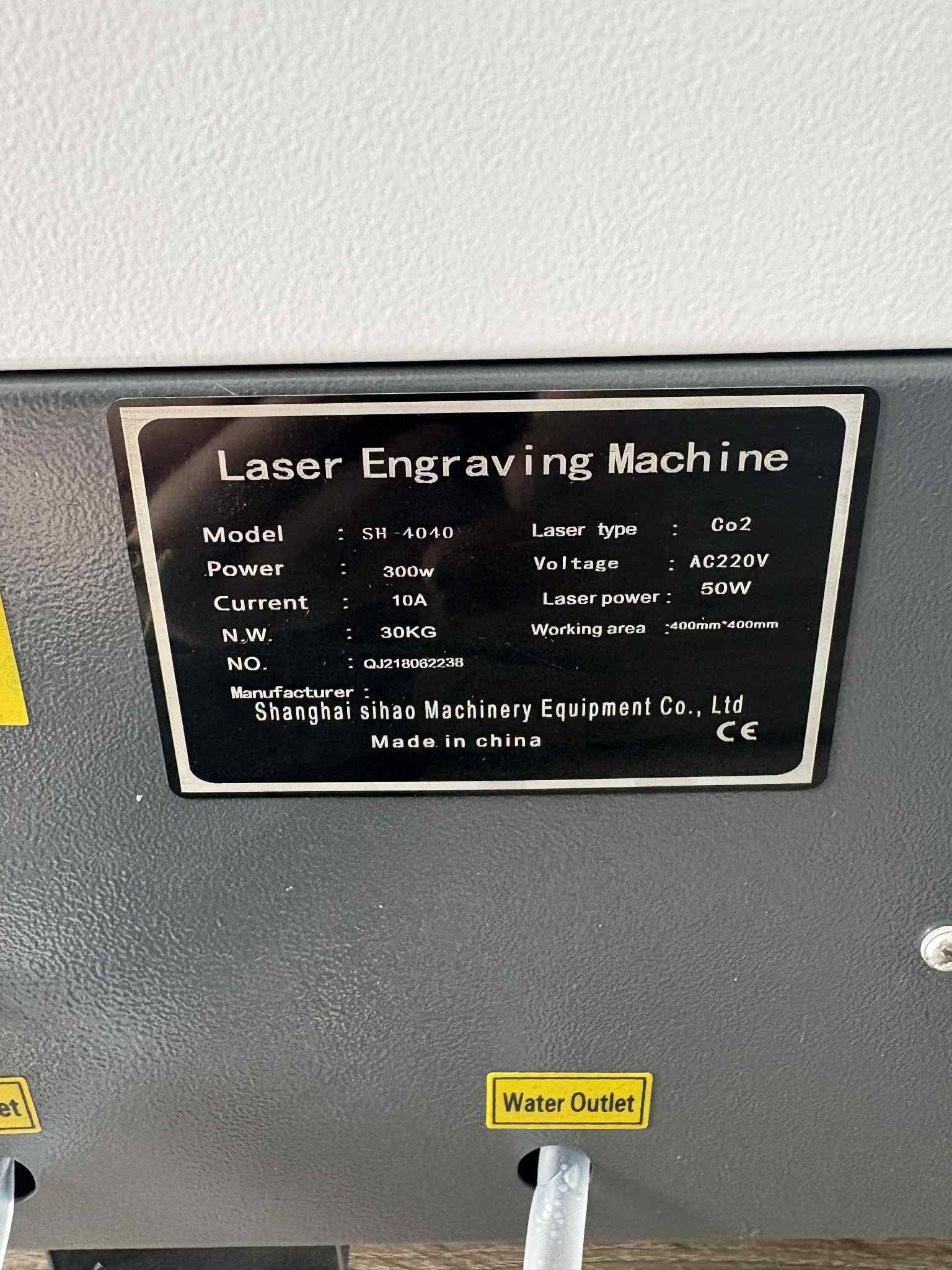

Hallo!

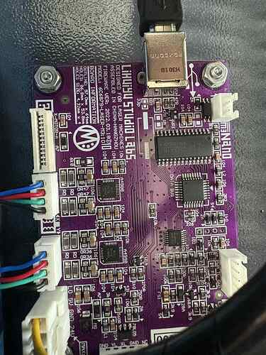

Ik heb een vevor 50w co2 lasergravure snijmachine aangekocht, maar nu wil deze niet werken met Lightburn, tot mijn grote frustratie want met een moederbord M2 zou dit niet compatibel zijn? Is er hier aan oplossing voor aub?
groetjes
This is a fairly common discussion point on the forum so I’d suggest a search for more detailed responses. Here are your basic options:
  1. Return your machine to the seller if that’s possible
  2. Swap the controller for one supported by LightBurn. This is a known reliably working solution. There are controllers designed to directly swap into M3 Nano lasers which make this easier or use a generic board but may require more work/parts to swap over.
  3. Use Meerk40t to drive the Nano board while providing Ruida or GRBL emulation. LightBurn can then connect to the Meerk40t server. I’d consider this more of an experimental support as I’m not aware of anyone relying on this for a robust solution. But this option is free and may be good enough for some uses.
