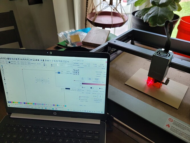

I have an xtool d1 pro and I’m using lightburn v1.4.0.
When I hit the Home button the laser positions itself a little more than halfway up the X axis and about 2 inches from the left hand side.(Y axis)
When I hit the Set Laser Position and click on the center of my drawing, it moves in unexpected ways, sometimes hitting the bottom or side rail of the xtool.

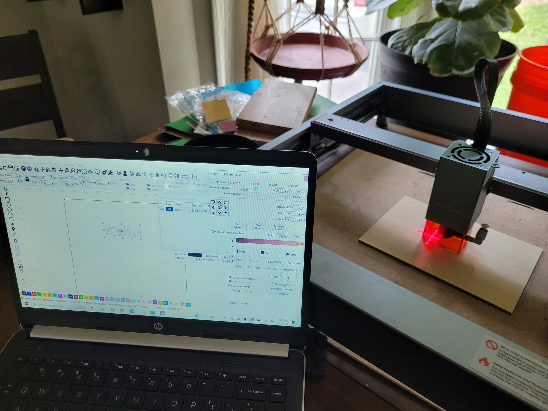

Yes the laser acts appropriately when using the Move functions.

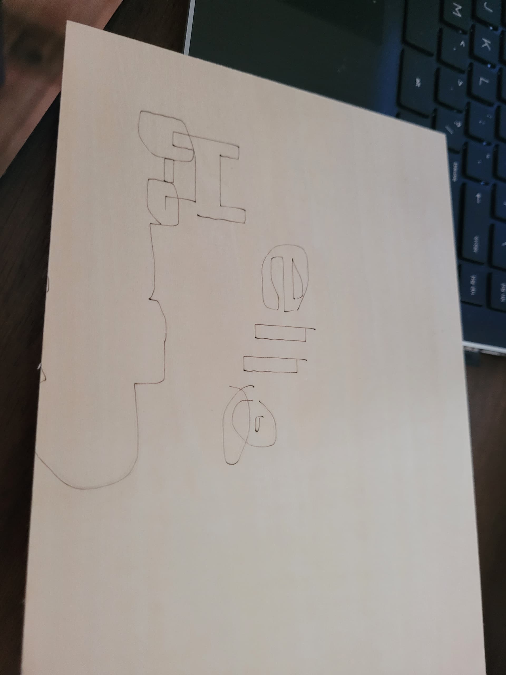

I drew a single word horizontally in Lightburn, “Hello”. I positioned the laser in the center and used Current Position.with the focus in the center of the 9 spot grid.
The laser did a very light burn but in a diagonal direction.
Please advise.

  1. full screenshot of LightBurn with the design loaded
  2. photo of the resulting burn from the perspective that it was burned in the laser
As far as I know I set the xTool up as described in the instructions.
It appears to me you have multiple issues going on. However, it’s hard to tell exactly what due to the compounding effect.
Start by dramatically reducing the speed setting… about 10x slower. You’ll need to also reduce the power appropriately. Then run a test.
This will reveal what other issues remain but looks like you may have some mechanical issues going on as well.

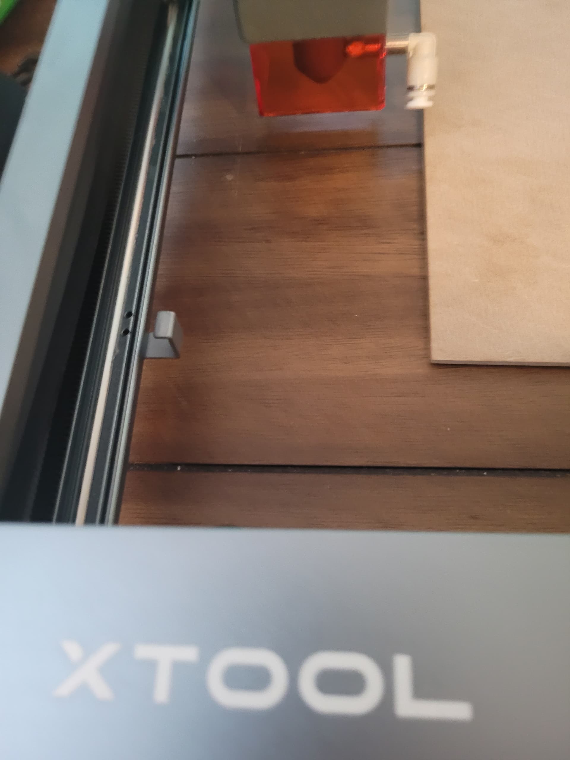

This may be a coincidence. The lbdev file should not have any effect on homing. If your homing is not functioning properly this is entirely a mechanical or electrical issue. Carefully inspect the area near the homing sensors. Is there a reason why they’re not being actuated near the home location? Make sure that no cables or other components are preventing the sensor from actuating.

Is it possible that the side rails are on backwards?
I checked and the laser does not encounter the flanges on the side that would trigger the limit switches seem ineffective in their current position.
See attached photo.
Hello.lbrn2 (15.0 KB)
That doesn’t look unusual by itself. Your machine should home to the back-left. There should be a similar tab at the rear of the machine.
Depending on the laser module that you have you may need to relocate the tab so that it’s able to engage properly.

Back-left? Does that mean Top-Left or Bottom Left.
It looks like the flange at the Top-left is too far forward to engage the limit switch and there is no way to relocate it other than drilling and tapping new holes.

Is it possible the front and back tabs are mislocated? Is there any ability to move the sensor?
Until homing is accomplished the controller on the laser cannot report accurate position to LightBurn.
You could attempt to manually home by powering on with the laser at back-left. However, this won’t work if your machine automatically homes at power-on.
“Move the sensor”?
The sensor is on the laser, isn’t it?
The bottom flange looks like should be at the top and the top flange should be on the top to be able to engage.

The yellow highlighted areas look like the sensors to me. The metal tabs when they cross in between the tongs of the sensor is what causes the actuation.
There are many issues with homing on these lasers according to the forum. Many times this is due to slight misalignments, sometimes this is due to not replacing the sensors that come with the frame extension, sometimes it’s due to the cabling physically obstructing the laser from fully reaching the back of the machine.
