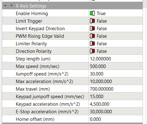

The Ruida controller must have homing configured for both the X and Y axes, which you can do with the LightBurn Machine Settings dialog:
Starting point:
  • Enable Homing = True
  • Limiter Polarity = typically False
  • Home offset = 0.0
  • Max travel = actual laser head travel distance
  • Max speed = typically 500 mm/s for CO₂ lasers
When you turn the machine on, the laser head must:
  • Move to the corner with the home switches
  • Activate both switches
  • Move slightly away from the switches
  • Tap them again and move away
  • Stop with XY coordinates = (0,0)
If that does not happen, then nothing else will work correctly and you must fix the problem:
  • If an axis moves in the wrong direction, invert the corresponding Direction Polarity switch
  • If the laser head does not stop at a switch, verify the switch works by manually triggering it.
When it homes correctly, then you can calibrate the axis motions and continue with other setup.

The Machine Settings moved from Edit to Laser Tools. With that open, the axis settings are under Vendor Settings at the bottom of the list. When you click the triangle to expand Vendor Settings, you’ll see a warning about wrecking your system: agree if you dare. :firecracker:

Return the wiring to its original state, then:
  • Change the Direction Polarity switch in the Machine Settings for that axis
  • Verify that the machine homes correctly when turned on
The jog arrows on the Ruida machine display should move the laser head in the indicated direction. If not, then change the Invert Keypad Direction switch for the incorrect axis. That change will (should) also make the LightBurn jog arrows in the Move window behave properly.
With those settings adjusted, the machine should home correctly, then jog as expected from both the machine display and the LightBurn Move window.
Then you can proceed to calibrate the axis motions. Ruida controllers use distance per step, rather than GRBL’s step/mm, but the process is the same.
Then set the axis speeds & accelerations to match the machine’s ability, which will require some experimentation. The values in my screenshot should be approximately right for your machine, but will certainly require adjustment.

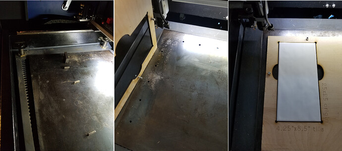

Uh, one more thing came up: the honeycomb. I assume it’s not advisable to cut through sth which lies on the frame, i.e. not on the honeycombs?
Then my cutting area is not 1000x600, but max. 960x620mm which annoys me a bit. Are there larger honeycombs available?
The question is if: can I place the 0,0 on the frame, which affects the desired new position of the switches.
I’d rather get a larger honeycomb and place the switches now to the mechanical maximum instead of the restricted honecomb (frame width 20mm all around).
Any alternatives to the standard honeycomb, like stretch metal? The problem will be the build up of molten material, I guess?
Kind of lost me here, I don’t understand what you mean. Mine has trianglular aluminum bars to rest the honeycomb. I took those out when I put in the metal plate.
I found the honeycomb didn’t work for me. The air went down the honeycomb instead of over the material.
I put a sheet of steel in mine and drilled locating holes for jigs. The plate wipes off pretty easy and isn’t damaged if struck by the laser.

You can move the controller’s origin point inward by changing the Home Offset value for each axis, without moving the switches.
The controller automatically moves away from the switch until it releases, then defines that position as “home” with the coordinate 0.0, so the Home Offset adds more distance.
Mine honeycomb just sat on the bars, there was no connection to ensure alignment. One of the reasons I got rid of it.
:grinning_cat:
I must’a got the deelux version, because the honeycomb frame has a pair of crudely drilled holes for M4 screws into the platform:
The frame holes aren’t perpendicular and don’t quite align with the holes tapped in the platform, but finessing the screws down locks the honeycomb in place. :man_shrugging:
Mine isn’t locked at all. didn’t bother me yet bc the material isn’t locked either, so if there’s a collision it will be displaced anyway.
