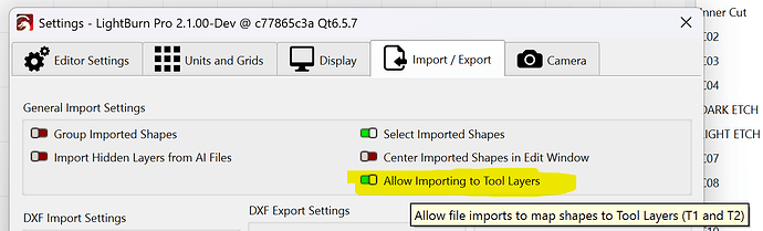

Do you have “Allow importing to tool layers” enabled in the settings in LightBurn?
Yes, this setting is enabled. The color translation seems consistent, i.e. Color 6 (turquoise) seems to always become Color 28 (bright green).

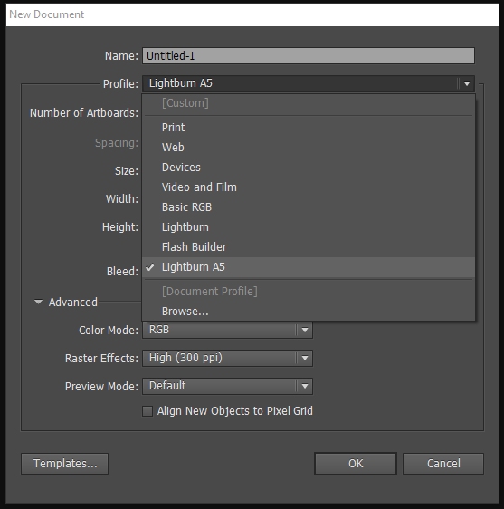

For Windows users, paste the A5 file into this folder:
C:\Users<User>\AppData\Roaming\Adobe\Adobe Illustrator CS6 Settings<en_GB>\x64\New Document Profiles
(Username & Language folder names may differ).
Doing this adds it to the “New Document” dialog box in Illustrator:
