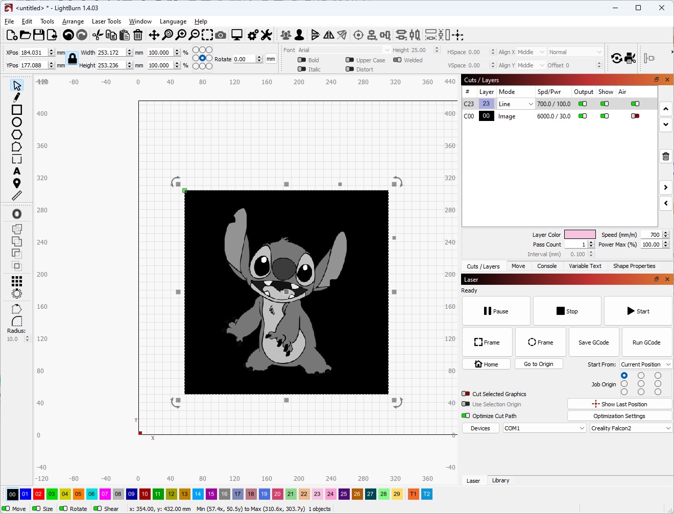

I have some EPS files that I downloaded online. I import them to Inkscape and exported as Plain SVG files. I then open them in Lightburn. Why doesn’t it show as a vector file with lines and instead is another picture file. What am I doing wrong? Thank you!

Here was another one I tried earlier. It imports as a image and not vectorized.
To confirm, have you made the necessary modifications in Inkscape to import EPS files? This would typically require you to install Ghostscript and make some environment variable changes.

If not, you likely wouldn’t be able to properly import the EPS file into Inkscape. One tip if you do this, after making all the requisite changes, I suggest you reboot your system. When I did this before nothing I did seemed to work until rebooting.

I don’t think I installed Ghostscript.
