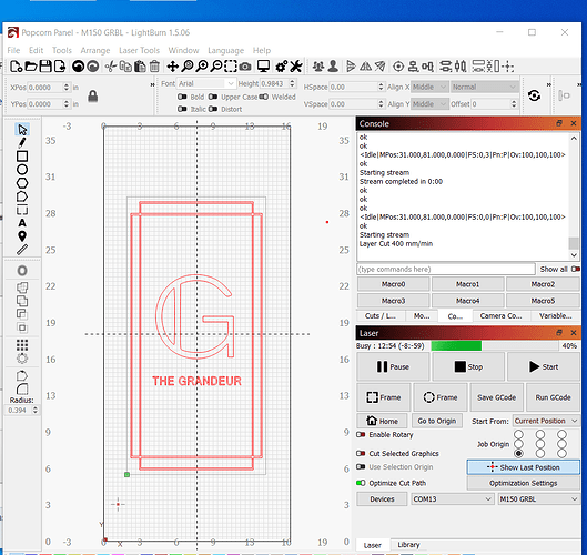

Lightburn keeps getting stuck on "busy" but is not firing or streaming correctly
Hello I have been having issues with my Windows 10 staying connected to my Atomstack X30. I will be working on a project and start it and it will all of the sudden stop running.
There isn’t an error and the console still thinks it is streaming and working. But when I click on machine settings I get the ‘communication with controller failed’ so I can’t see the settings.
I have replaced the USB cable, reinstalled the previous version of Lightburn as well as the driver, disabled sleep and actually reset my entire computer and it is still happening. Can someone please help me. :pray:

I bought a brand new cable and it worked last night for a minute and now stops and is doing the same thing. Connects briefly through the COM port but then there is no machine settings and doesn’t move.
I brought it in doors and it is still not connecting to Lightburn and just looks like it is connected but nothing happens and no movement or machine settings come up.
