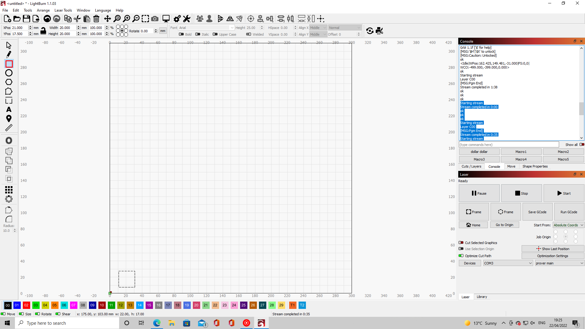

so i homed it then drawn a 20x20mm box on absolute coordinates which worked

this is after homing
<Idle|WPos:0.000,0.000,-1.000|FS:0,0|WCO:-499.000,-399.000,0.000>
ok
in the screenshot above the outer box is as far as my machine will go before hitting switches
my maximum travel is 260mm left to right
and 316mm up and down
sorry don’t know which it is x or y
Hmm… in that case I do wonder if @JohnJohn was on the right track about calibration. I don’t understand how you were able to use current position for the perimeter then.
Change these to:
$100=80
$101=80
$102=80
Rehome and retest limits. Then draw a square with specific dimensions like 100x100mm. Then measure the burned dimensions.
We may want to fix your max travel dimensions and the offset later since your size in GRBL is currently 500x400 mm.
