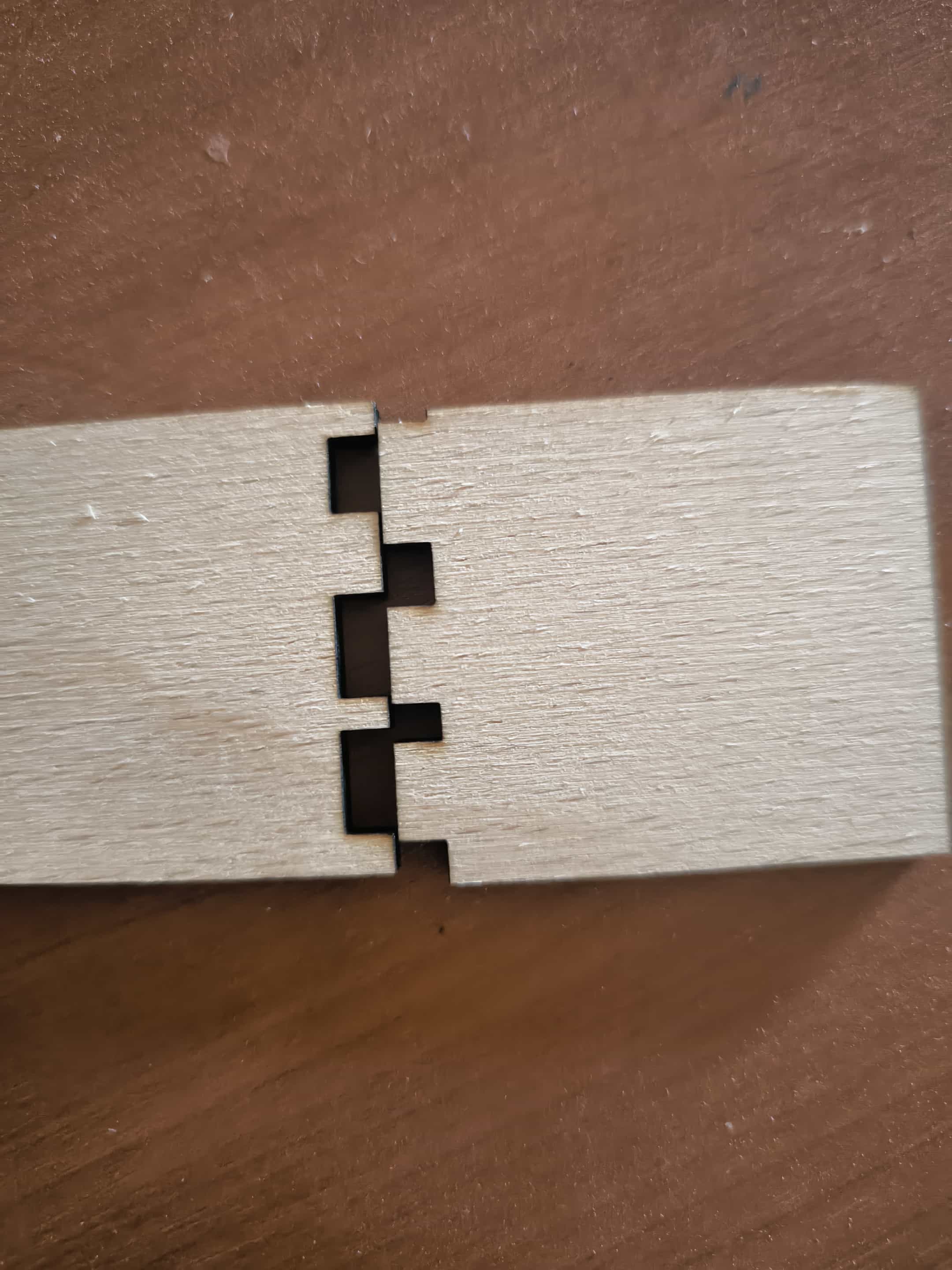

I quickly designed some finger joints and did some test cuts.
The results were inconsistant and messed up. The shapes were 100% closed, checked them.
I tried it with 0.08mm, 0.1mm and 0.15mm kerf
https://imgur.com/a1xAOCO
https://imgur.com/a/TEG2Aer
These are the cuts.
Any ideas what went wrong?

But when I try the built in kerf offset in LB the fingers get messed up(as shown on pictures)
And I don’t want to rely on boxes py, I’d rather do my own designs but this makes it impossible unfortunately.

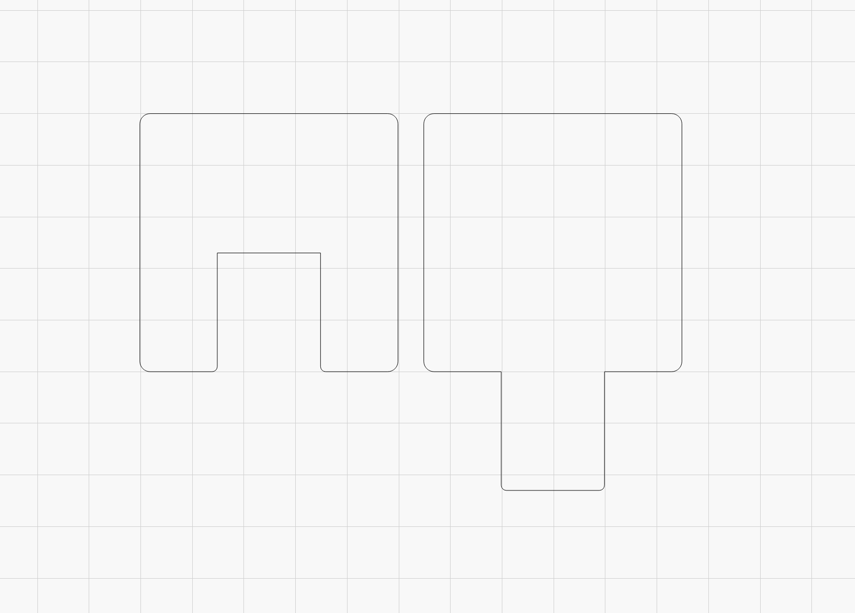

This was designed with even lenght and width fingers and after the cut with 0.08 kerf this is how it came out.

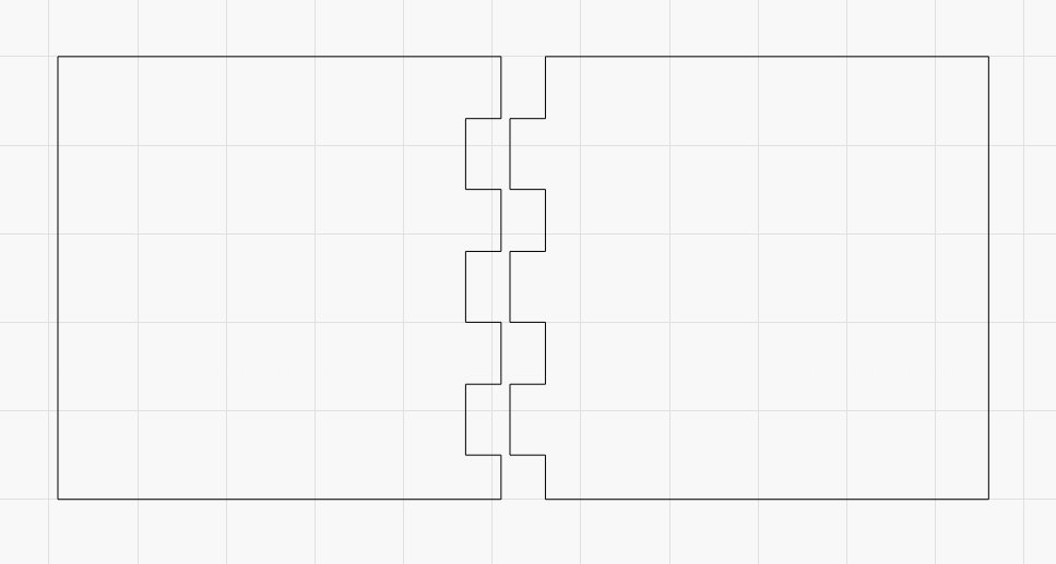

Just to give you a visual representaion, this was the design I cut.
It is very unusual, I design my boxes almost exclusively in LightBurn (and there are many different ones) without ever having the problem shown. There must be something in the process you are doing wrong.
Can we have a look at that file?
Cut.lbrn2 (4,7 kB)
Sure, let me know if you see anything unusual.
Apart from a very slow cutting speed, I can’t see any problem with the file.

Update. I managed to make it work. I have moved my setup to a new PC and it turns out all of my settings were messed up.
I wish I could tell you what made it act like this, but I just copied my settings from my old setup and now everything works as intended.
It’s great that you found a solution, sometimes technology is mysterious :wink:
