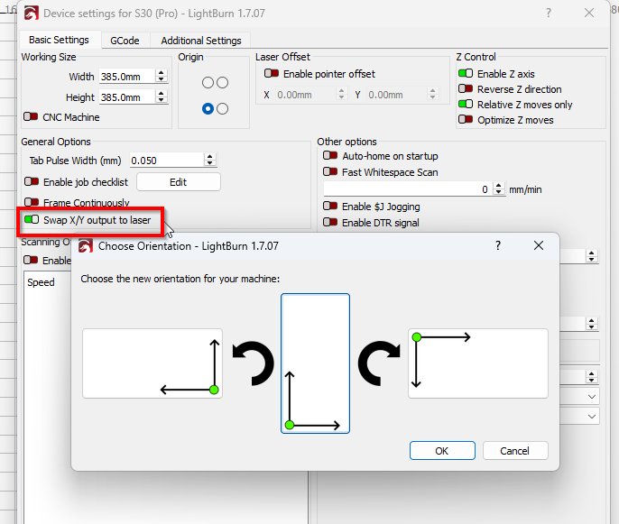

Forgive me if this has been asked but has there been any discussion of making it so that the work area in the app can be rotated so that those of us with 400x800 work areas can design with that in a landscape layout instead of a portrait layout. I know we can rotate afterwards but I think it would be nice to be able to design with the x in the vertical and the y in the horizontal.
Yes, you can:
That is awesome. Thank you
