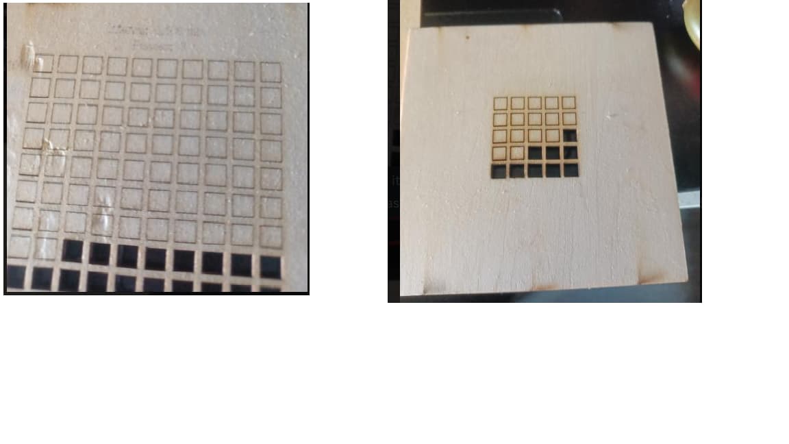

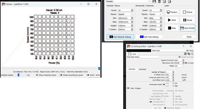

I got a longer Ray 5 5w laser engraver. Been playing around with it for a few days now, messing with different speeds/powers to find the best settings for the job I am trying. For some odd reason and I still haven’t figured it out. On the material test, it doesn’t seem to want to engrave the power/ m/mm speed on the side like it shows in the preview. On the first one I did, it kinda did it, but everyone following after just does the cuts. Added pics for reference.
The text on the sides uses the parameters in the Edit Text Settings screen - make sure you don’t have it set too low-power or too fast.
I feel silly now. Thank you
