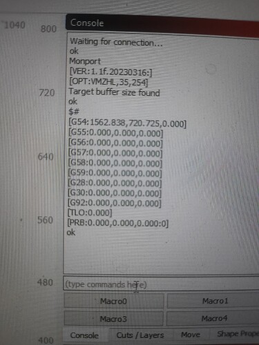

In console type
Press enter
Check to see if you have any persistent offset
Also you did not clarify what machine you have, but is it homing normally?

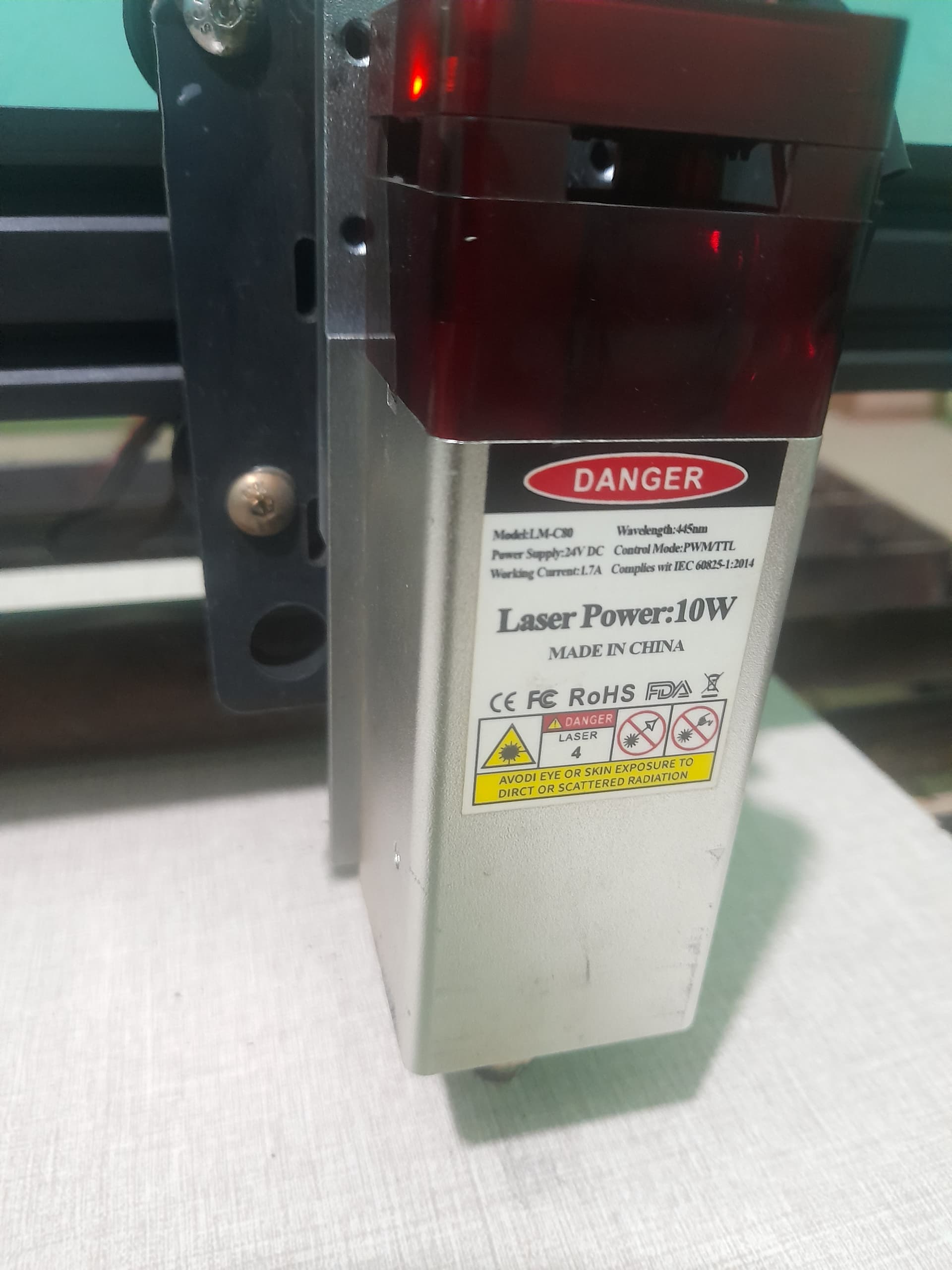

It’s a laser engraver I will attach a photo.
And no it does not home we have disabled the limit switches.
That is the laser module, not the laser engraver.

You have a G54 offset
Type in console
G10 L2 P1 X0 Y0
Press enter
Then try again
G54 line should be clear
If so then try again engrave
It is clear now.

Off topic what is the difference between the Laser Module and a Laser engraver? We bought it from a local seller and we have always found it hard to name it so we usually image search it or something.
How can I find out? The firmware and machine
The laser engraver is the chassis
Frame + Motherboard combo
The laser module is the business end that actually lasers
They are interchangable and by just the laser module i cannot tell what your machine/motherboard is, and vice versa

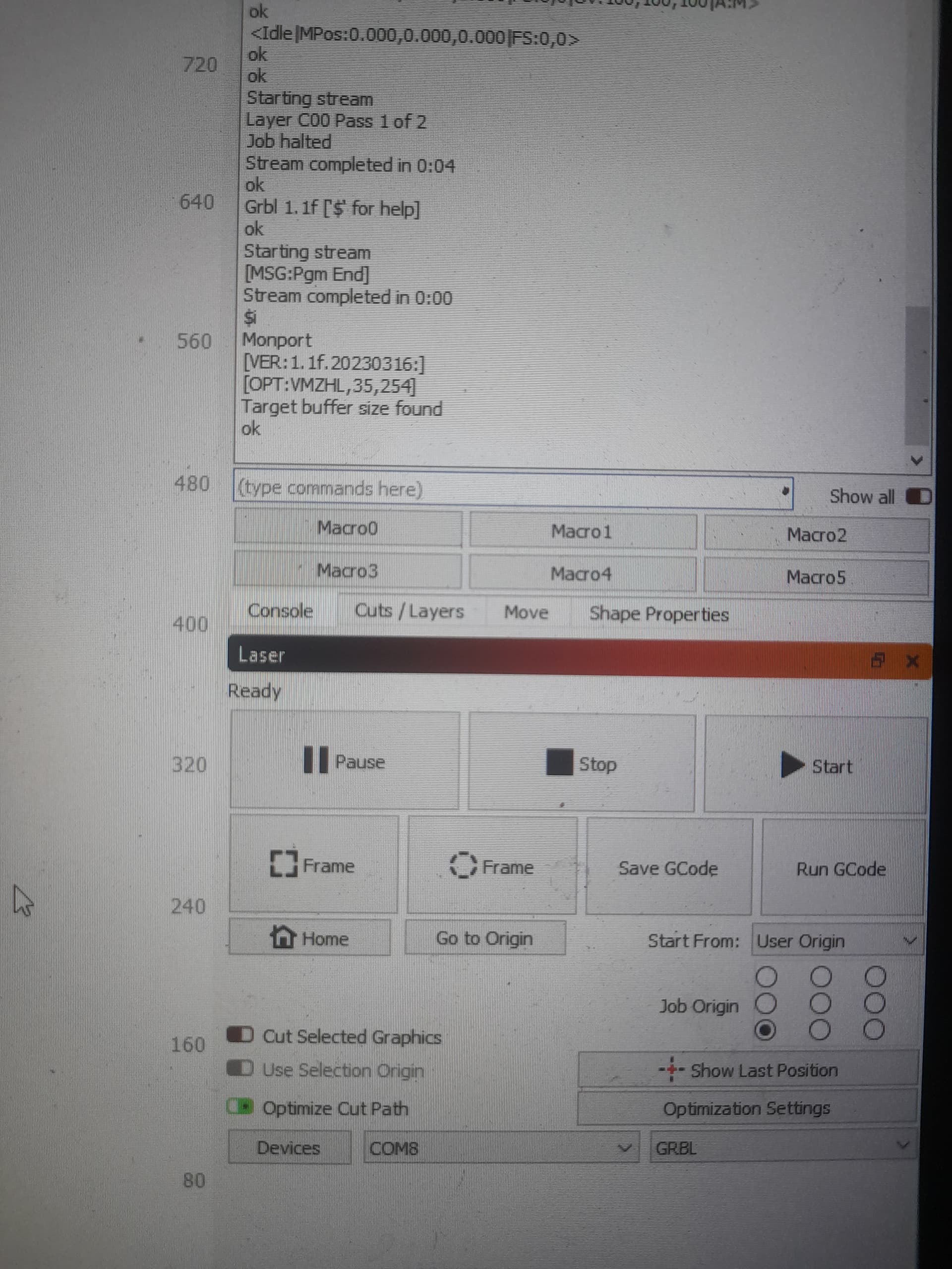

type $i in console
But should be a branded machine?
Here is the result. Should i also send the controller will that help?
