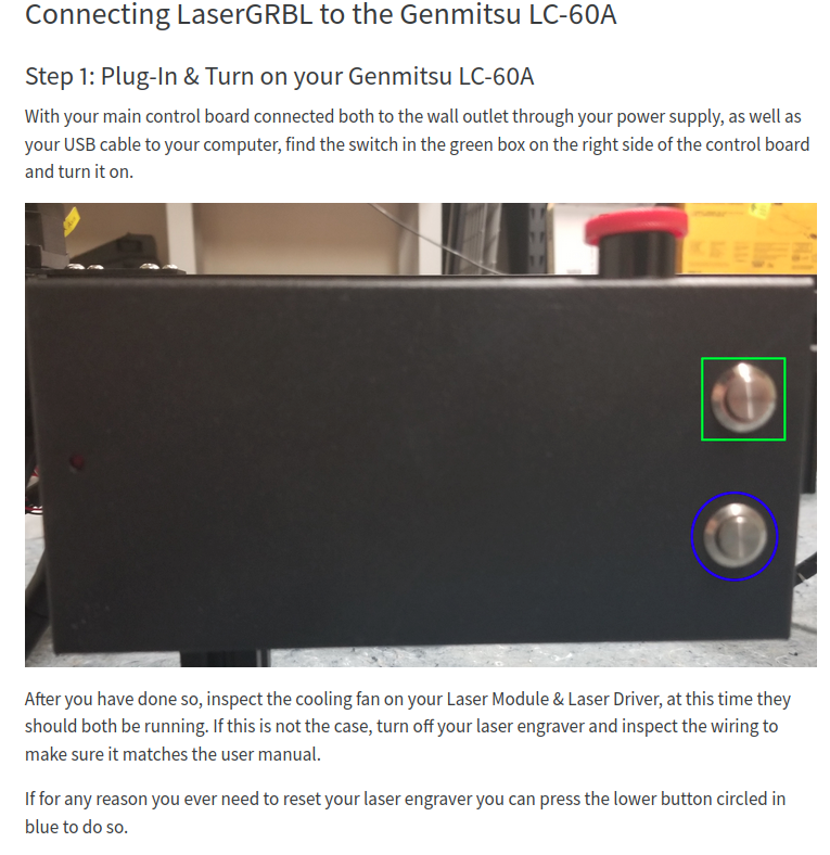

Depends on what you call ‘manual’… and don’t call me Shirley… :crazy_face:
This laser is supposed to have a similar or same controller… are these buttons available?
@berainlb comments are good to follow.
When a grbl board detects the limit switch, it knows it’s ‘lost’. If everything is ok then it would not go out of the work area. Once this kind of error occurs the only recovery is a ‘reset’ which generally includes a homing operation to know where it is.
The $X unlocks grbl commands and you need to home it next…

My unit does not have a “manual” button like controller shown for the LC-60A. I can only do the clearing via software.
