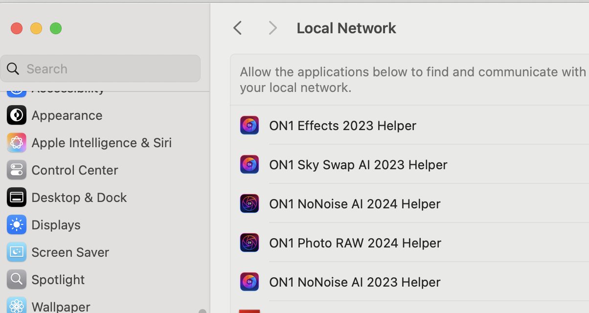

I cannot get Network permissions set. Lightburn does not give me access to set Network permissions in Privacy & Security-> Local Network:

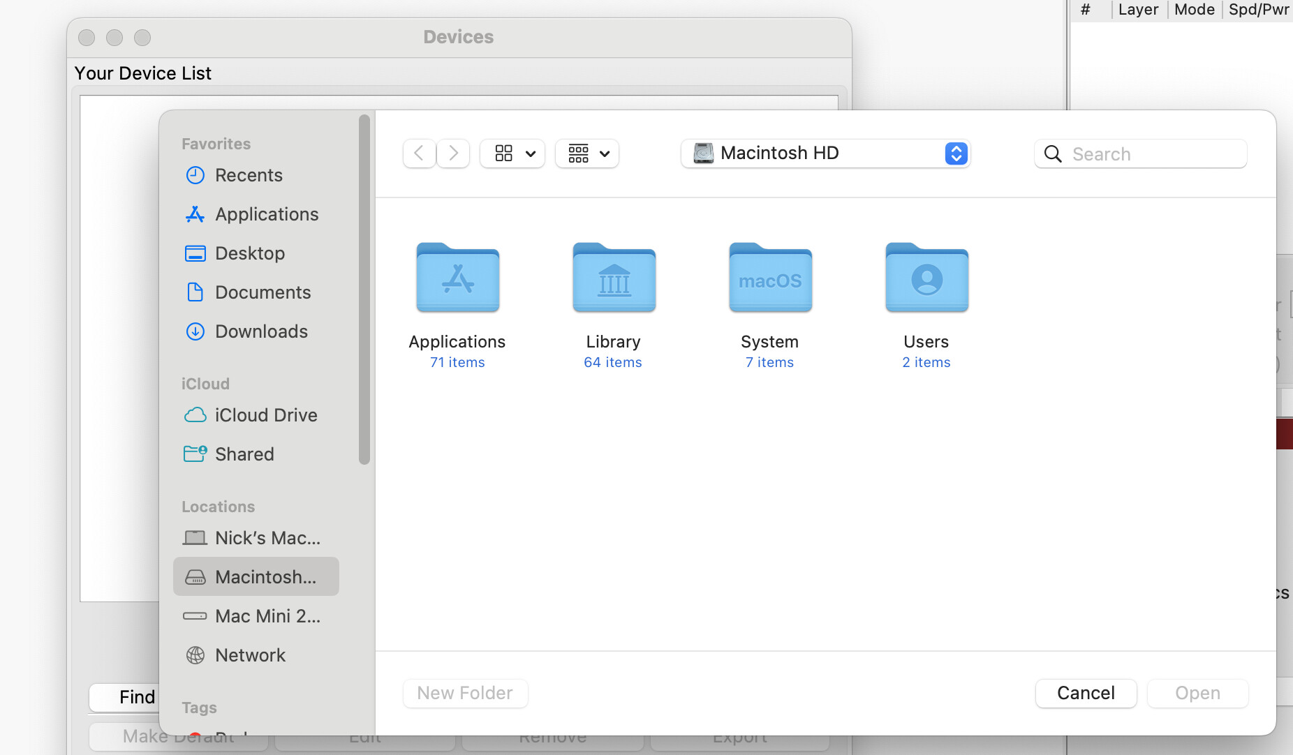

I just bought a Thunder Bolt Plus and want to connect Lightburn to it through Ethernet. The Ethernet network IP addresses are set on the computer and the Laser. However, when I try to import the files from thunder Bolt, it cannot find the dongle.
It would be listed in locations.
I am assuming that the reason I can’t access the dongle is because Lightburn is not authorized(permitted) on my Mac. When I look at Permissions->local network, Lightburn is not listed for me to set that permission.
I think the bottom line is how do I get my OS to grant Lightburn network access?
Tim (and anybody at Lightburn) I found this on the apple community board:
Local Network Privacy is new in Sequoia. The developer would have to update the app with a “multicast entitlement” so that it can be granted access by the user. You can’t do it yourself.

I can ping my Thunder Laser successfully. I do NOT see the Lightburn app in my Privacy->Local Network list of apps. So I can’t give it permission.

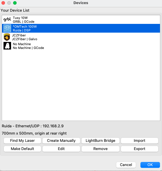

I’m not sure what criteria needs to happen for Lightburn to request access. Did you go through the setup process in Lightburn for connecting your laser via Ethernet? It may not request access until you go through this step.
Edit: Show a screenshot of your devices window with your laser highlighted, like this.
I am using direct connection to my laser. I went through the pre-processing instructions per Thunder(setting up the network for IP addresses that don’t conflict with my house router). That all works fine. Are you talking about manually adding the device? That’s where this all came from. Supposedly, After the laser can communicate with Lighburn, when I manually import the laser, it dumps all the Bolt settings into Lightburn. But Lightburn doesn’t recognize the mac’s network permissions.

Did you go through the Lightburn Device Setup process where you tell Lightburn the IP Address of the Bolt? Not an Import of any file, it’s a Manual setup?
Please show your Device window that I asked for above.
I did not do that. I will do that.
That. was it, Tim. When I entered data for the Ruida controller, Lightburn then asked to access the network. When I said yes, all was good. I went to Privacy->Local Network and Lightburn app was there!
