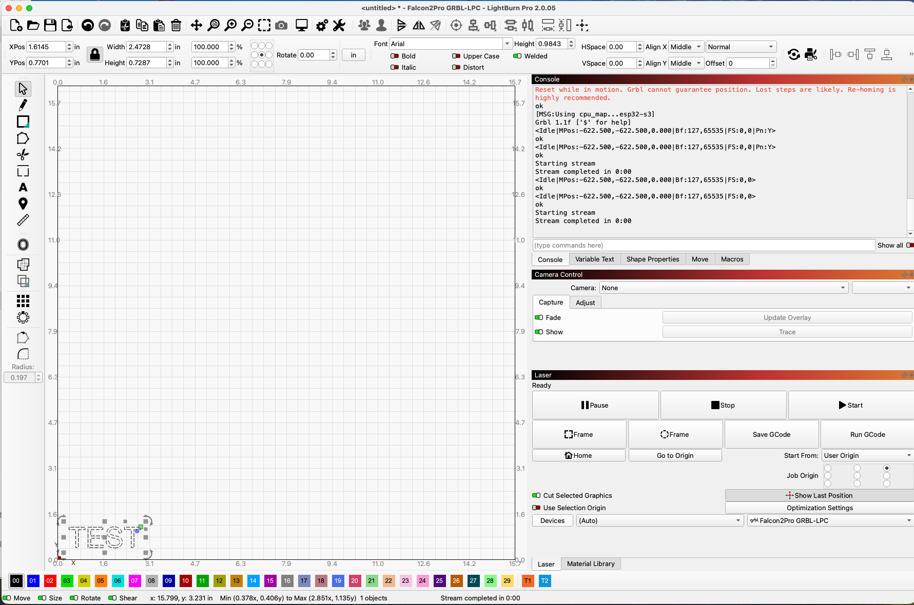

Here is my firmware info as well as a screen grab and the file I used.
[VER:1.1f.20220810:]
[OPT:VHL,127,65536]
Target buffer size found
[software versions: CV50-Pro-MASTER-Release V1.0.0 20231129-1024]
Also attached is a screen grab
Test File.lbrn2 (12.8 KB)
This is unlikely to matter but the bundle you sent me was for a GRBL device and you are showing a GRBL-LPC device. LPC is made for smoothie boards running GRBL and is not the right protocol for that machine. I just tried changing to an LPC device type and homing still worked correctly so likely not your issue but something isn’t matching up here.

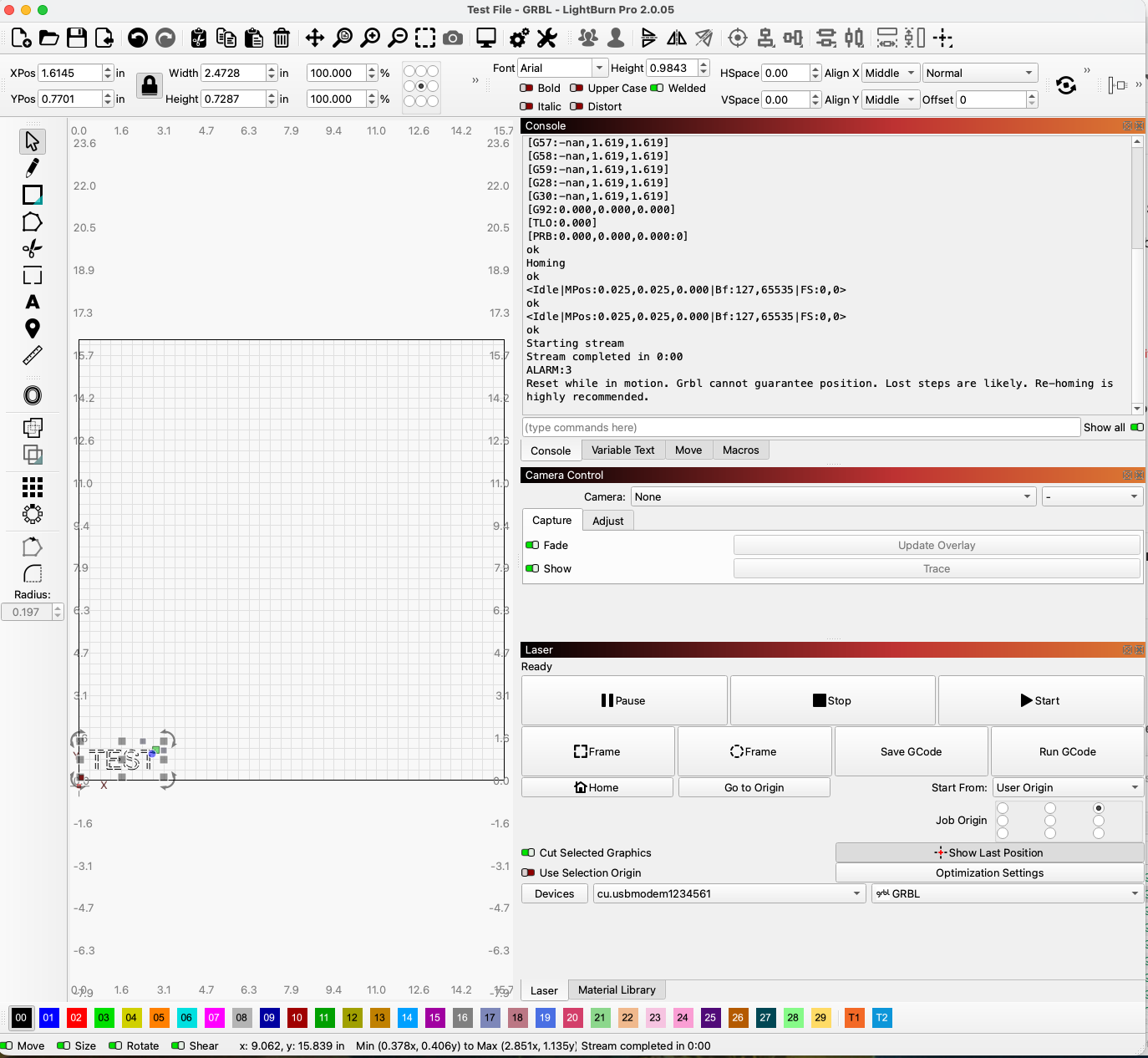

If you click show all on the console and frame your job what do you see.
If it works fine on mine there’s no reason it won’t on yours. Just need to figure out the hiccup.
When I frame, I see this:

[G54:-nan,1.619,1.619]
[G55:-nan,1.619,1.619]
[G56:-nan,1.619,1.619]
[G57:-nan,1.619,1.619]
[G58:-nan,1.619,1.619]
[G59:-nan,1.619,1.619]
[G28:-nan,1.619,1.619]
[G30:-nan,1.619,1.619]
[G92:0.000,0.000,0.000]
[TLO:0.000]
[PRB:0.000,0.000,0.000:0]
ok
Homing
ok
<Idle|MPos:0.025,0.025,0.000|Bf:127,65535|FS:0,0>
ok
ok
Starting stream
Stream completed in 0:00
ALARM:3
Reset while in motion. Grbl cannot guarantee position. Lost steps are likely. Re-homing is highly recommended.
