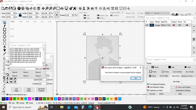

When I bring up a file and its not a lghtburn file it says there is no file to print though there is avery faded image on my screen. This happened after I had done burning just a few minutes earlier. I have restarted the program and my computer but it didnt help. Im lost, please help

Can you take a full screenshot of LightBurn showing this message?
Toggle the Output flag on for the layer that you want to burn.
