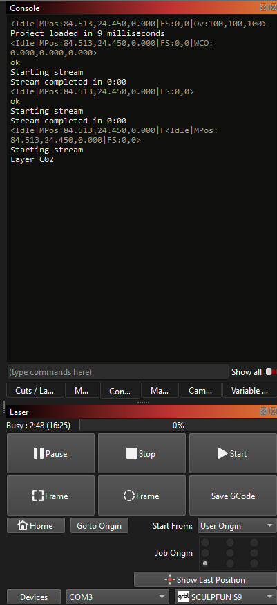

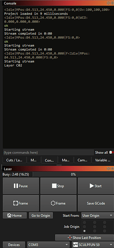

Ok, I opened one of my projects this time, I hit frame and the laser framed the test perfectly, I then hit start it started ran for 20 sec and stopped. Lightburn says Busy and 0% The output

This is another indication it might be a communications issue. Try these:
  1. A different USB cable.
  2. Unplugging both ends and plugging them in a few times to clean the contacts.
  3. A USB cable with a ferrite (knot) on it.
  4. A USB cable that does not exceed 10’ (9M) length.
  5. A quality shielded USB cable with a ferrite.
  6. Use a powered USB cable hub. If PC USB is Type-C, insert a USB-A hub in between the PC and the Laser (PC USB-C cable to USB-A Hub USB-A cable to USB-C Laser).
