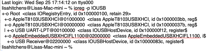

Hi Lisa
Might need to check what the OS itself sees
Do this tests - with your multiple cables and adapters
But start Without anything connected
Open a Terminal - then type this code in and press enter
(it will list all USB devices)
ioreg -p IOUSB
Get a baseline image and save it with no USB device connected.
Then try the same code as you plug the laser with the multiple cables. If no cable creates a change on the listed devices there might be a USB problem
(Also if possible use a Windows computer for sanity check?)

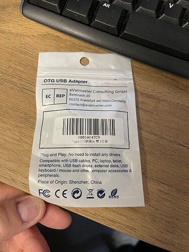

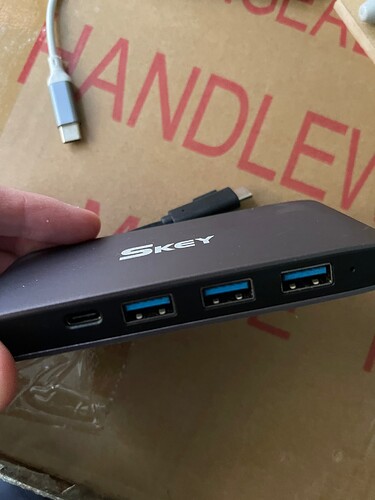

The adapters I am using are these:
Adapter 1:
Adapter 2:
I did perform the test in the Terminal and I’ve attached a file with the outcomes.
Adapter tests.txt (4.1 KB)
I don’t have access to a Windows Laptop at all.
Note Adapter 2 - with laser shows devices

I think the problem might be - your hubs are a bit too smart
And the last 2 are not hubs per se is just an adpater
You might need something like this
note that is as “dumb” as you can get it - which is the goal
