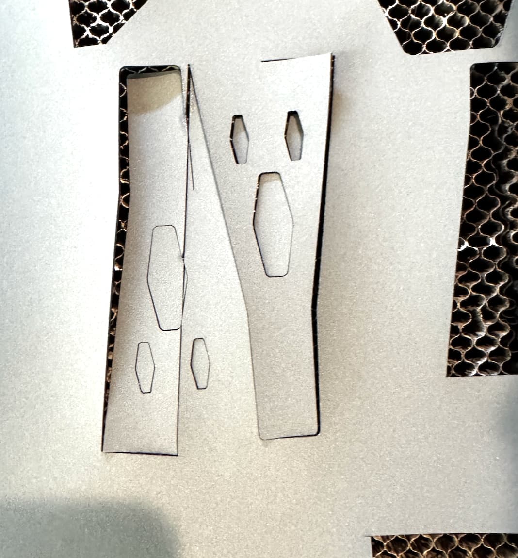

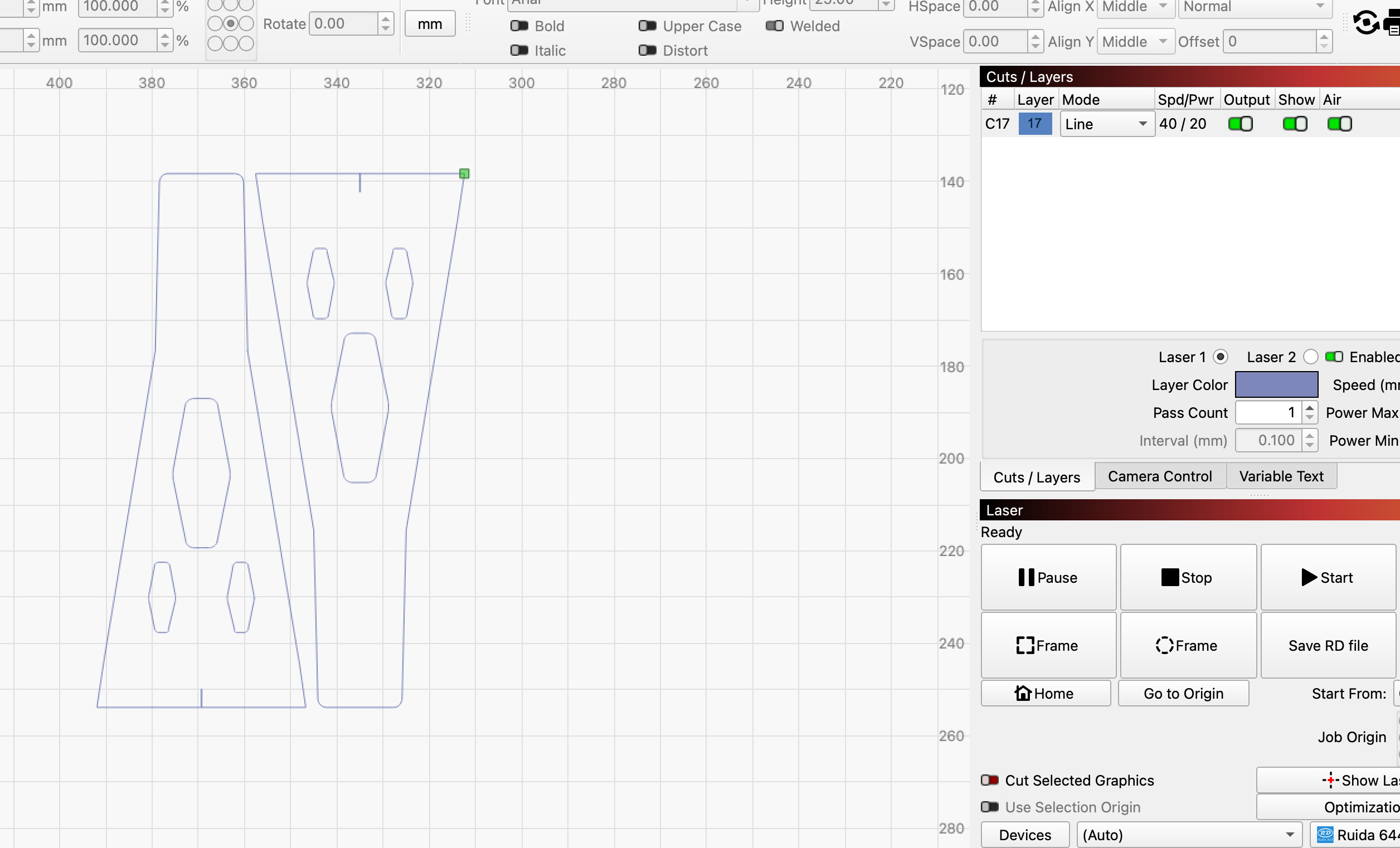

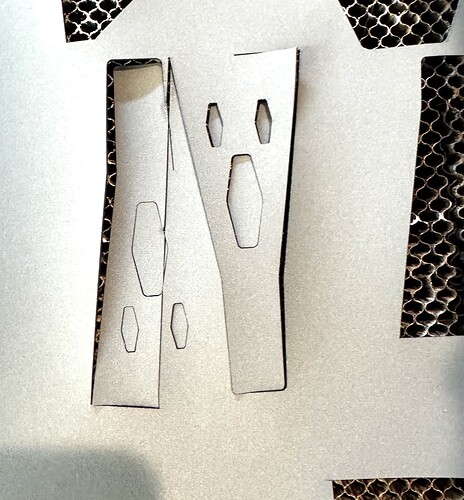

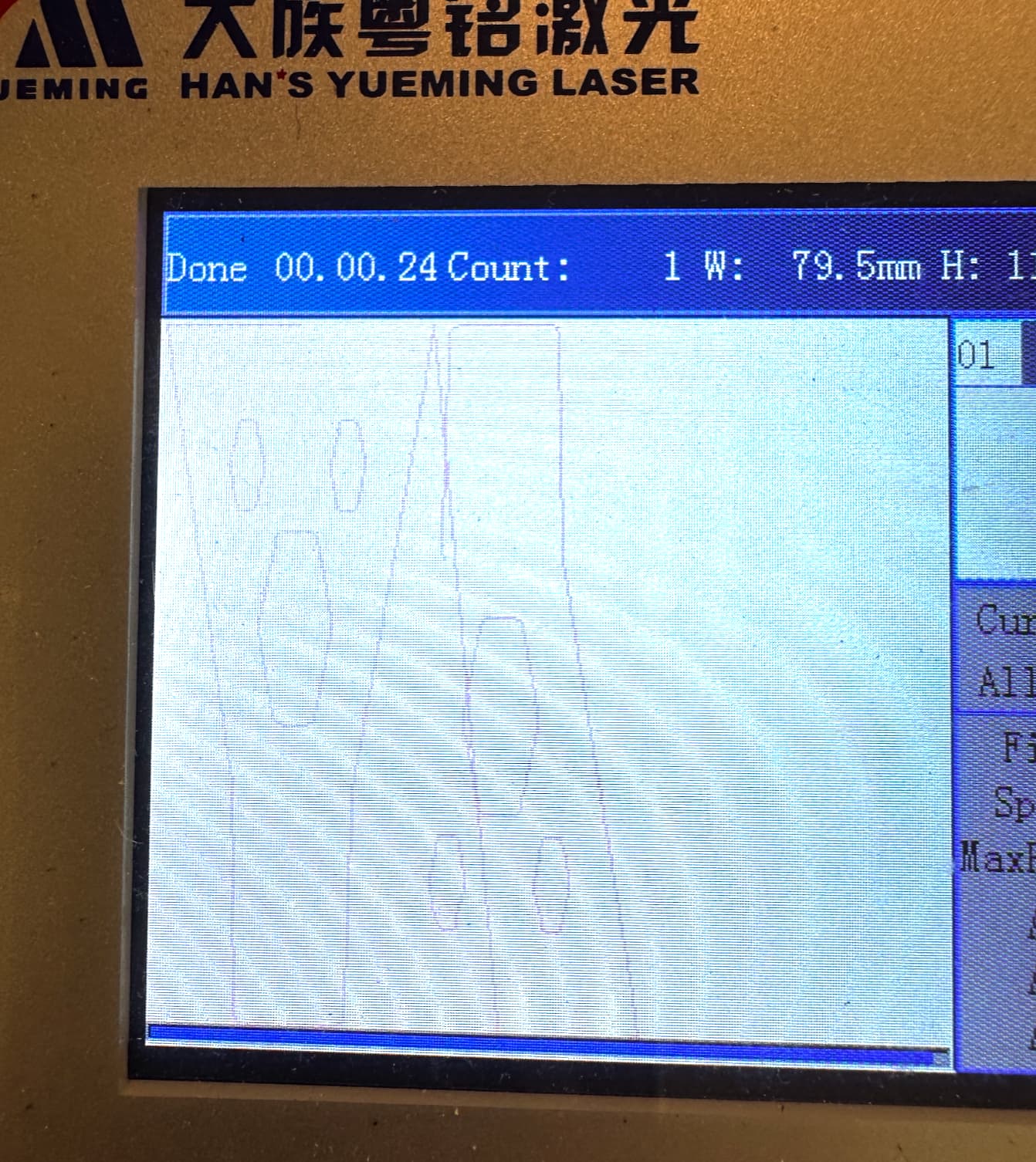

I copy/paste my paths from illustrator, and they usually work great, but today Im experiencing some cut paths that don’t match what I see on the screen. I can preview the cut animationm in Lightburn and it looks OK, but the actual cut is incorrect.
The preview in Lightburn looks correct, but the preview on the laser matches the cut.
Make sure your controller doesn’t have too many files stored in it. Ruida controllers do strange things when their memory gets full. You can delete them quickly through the files window in Lightburn.
If that’s not the issue, I don’t have any other ideas, maybe someone else does.
Odd intermittent failures with a Ruida controller seem to come from USB communication problems, particularly with Macs.

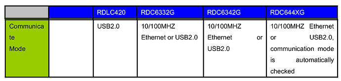

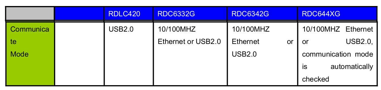

I have a bunch of CAT 5E, will that work or do I need CAT 6?
Yes, Cat 5 is rated as 10/100MHZ Ethernet, same as the Ruida.

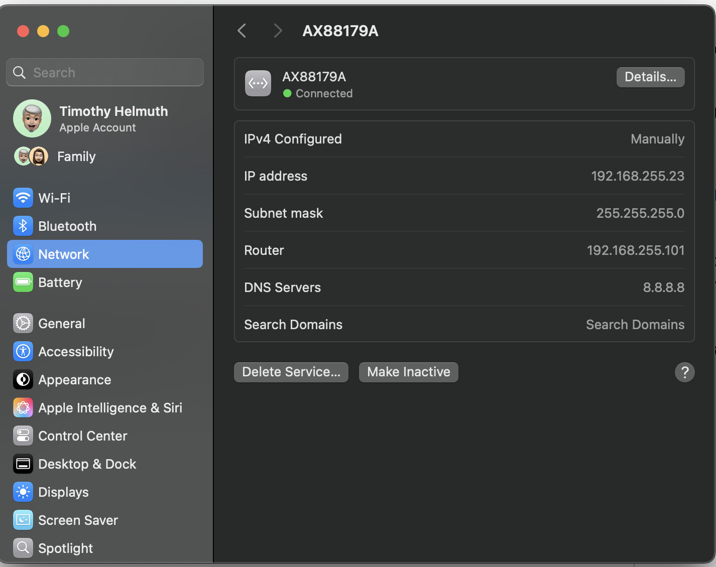

I just ran a test connecting directly. To verify, please go to Settings>Network and click on your ethernet adapter. It should look something like this. It will have a different address than your WiFi Adapter. This is the IP you need tou use in the Ruida, changing the last number to something different. One off is fine. Also be sure to change the gateway in Ruida to match the Router in Settings.

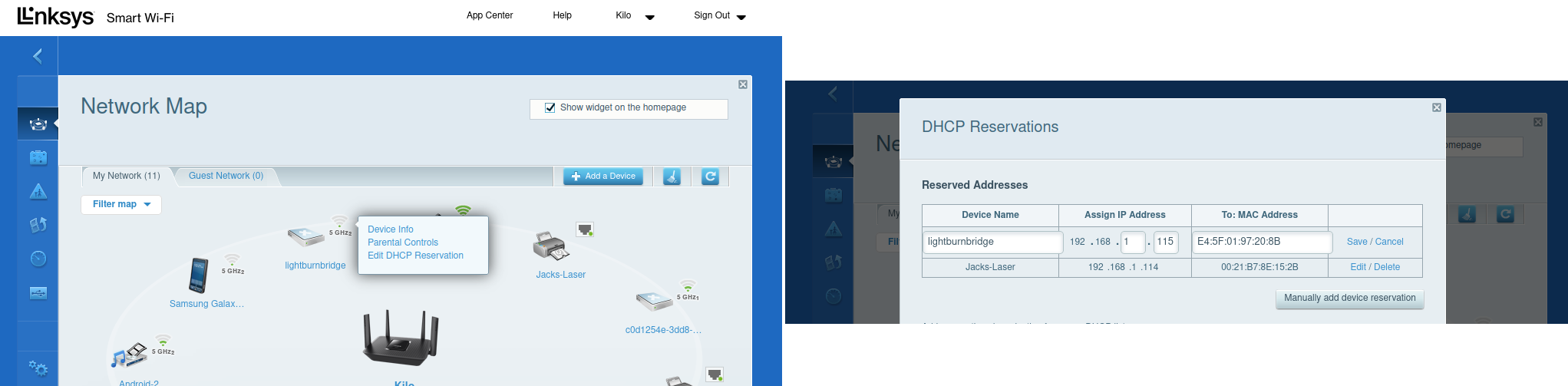

I think going through the LAN is better. Just need to assign an IP address that’s outside the DHCP range of your router. That way it won’t asssign that address to another device causing issues. But I know that’s not always an option if you don’t have a switch within reach of the laser.
Interesting observation is when I connected directly with my Macbook, my WiFi internet connection stopped working. I didn’t bother trying to troubleshoot since this was only for a conection test. I reset my Ruida back to connect via LAN and everything’s happy.

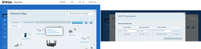

It’s very easy to just right click the device and assign an IP based on the devices Mac address.
I’ve generally done it this way..
You have to tell the router to not include that I.P. address in the DHCP pool, making it a fixed I.P.
