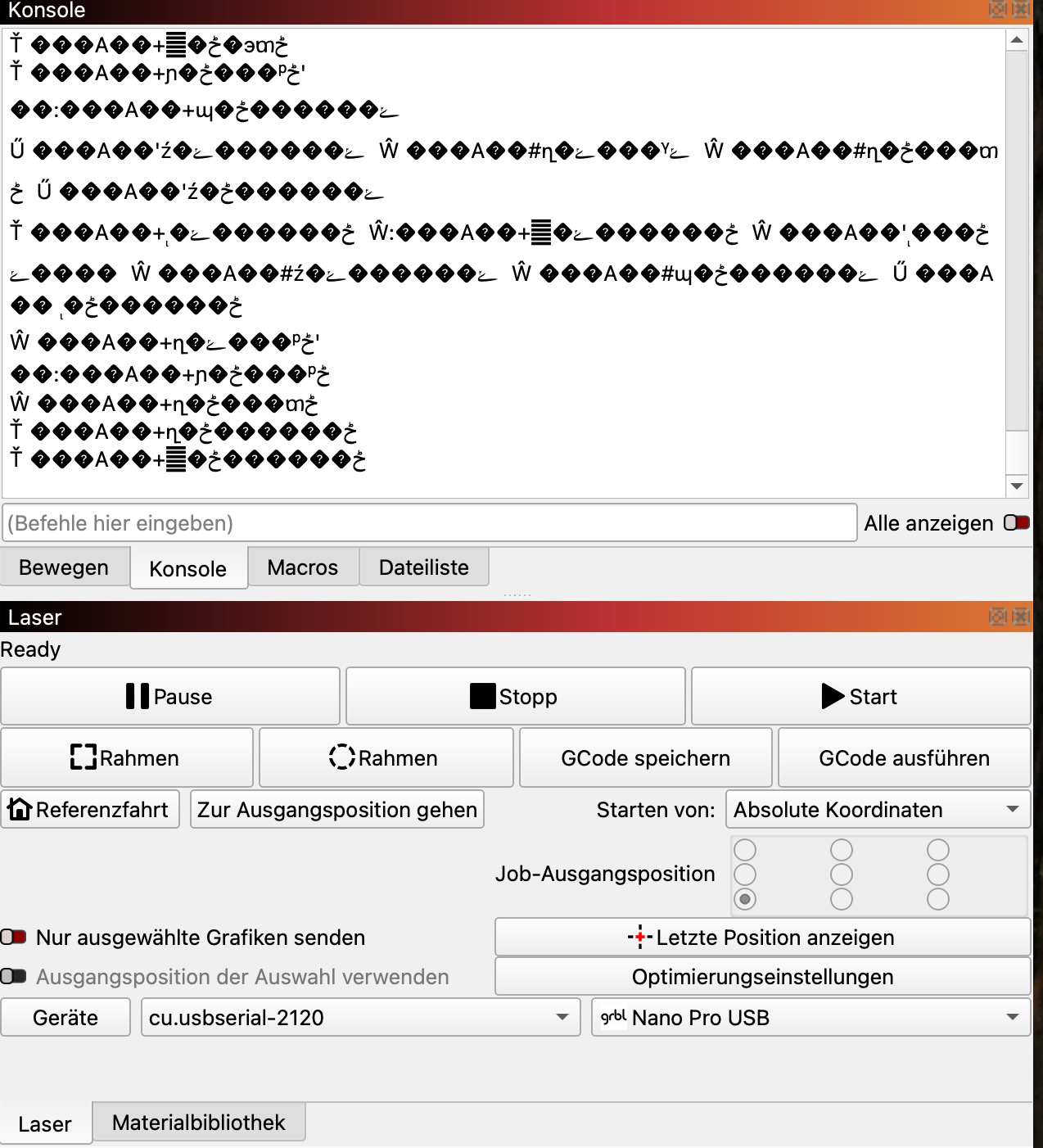

I’m trying to get my Longer Nano Pro 12W laser working with LightBurn on a MacBook M4 running macOS Sequoia 15.3.1, but the device isn’t being recognized at all. I’ve spent several hours trying different approaches, but the CH340/CH341 driver simply won’t load or appear in the system.
Here’s everything I’ve tried so far:
  1. Installed the CH340 driver from Longer’s website
    – Followed the official instructions (.pkg installer).
    – No driver appears in /Library/Extensions.
    – No security warning or “Allow” button appears under Privacy & Security.
  2. Installed the official WCH driver from wch-ic.com
    – Ran the CH34xVCPDriver.pkg installer (no error or prompt shown).
    – After reboot, there’s still no /dev/tty.wchusbserial….
    – Checking /Library/Extensions only shows HighPointIOP.kext and HighPointRR.kext.
  3. Changed macOS security policy
    – Booted into Recovery Mode → set Reduced Security → enabled
    “Allow user management of kernel extensions from identified developers.”
    – Rebooted, but still no CH34x driver in /Library/Extensions.
  4. Tried manual and Terminal-based installation
    – Attempted to extract CH34xVCPDriver.kext from the .pkg manually (not visible in current WCH package).
    – Tried sudo kextload, but got No such file or directory.
So at this point LightBurn cannot detect the laser at all — ls /dev/tty.* shows no wchusbserial entries.
Has anyone successfully installed the CH340 driver on macOS Sequoia 15.x with an Apple Silicon (M1–M4) Mac?
Or can anyone share a working method or driver version that properly exposes the serial port for the Longer Nano Pro 12W?
Thanks so much for any help or confirmation :folded_hands:
(MacBook M4 • macOS Sequoia 15.3.1 • LightBurn 1.x • Longer Nano Pro 12W)

If you launch LightBurn AFTER you power the laser, and check the dropdown. do you get a serial port ?
It is there listed.

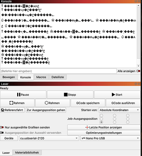

Hi Gil,
yes I see it and it´s connected, but the console shows weird signs:
I played with the baud rate as well, but that didn´t help either.
Also, after the installation of the CH34x USB to Serial Driver, I only find the cu.usbserial-210, not a wchusbserial…
