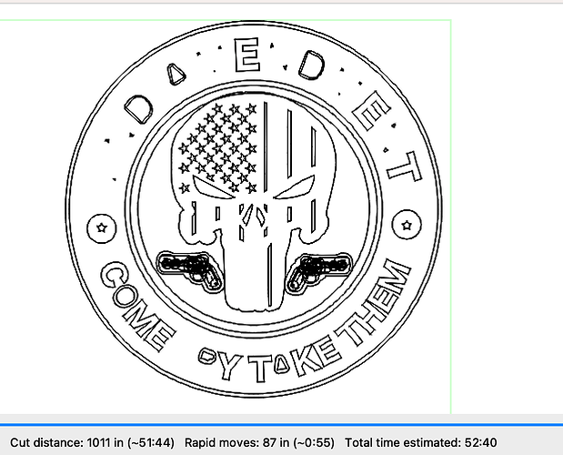

I have been uwsing lightburn for several months now ane use it to design most all my projects. Tonight I am havi ng issue never seen before. When I run preview I see my project but then it engraves completely over it making it appear blank aFTERWARDS. Does anyone have an idea? I sent both files a screenshot and the original file. Appreciate any help?
I am wanting the center part to be white. SO YOU can see the gun easier.

Heres rthe lightburn file and another screenshot. This one looks worse

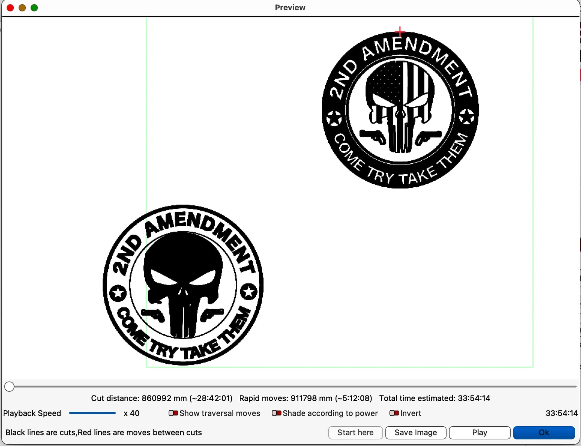

You have a kerf offset in the layers. I removed that and here’s what I got in the preview.
Is that what you’re looking for?
(EDIT) There are also 8 tiny shapes that weren’t closed. I removed those. I changed the layer to Fill. Then in the lower left graphic, I added a small offset to the circle around punisher so that the background would be un-touched.

Yes thank you. For some reaason lightburn adds that kerf and I forget to look at that as a problem. Any idea how I settthe kerf and it stay to my setting
Set your desired settings, then push “Make Default”.
