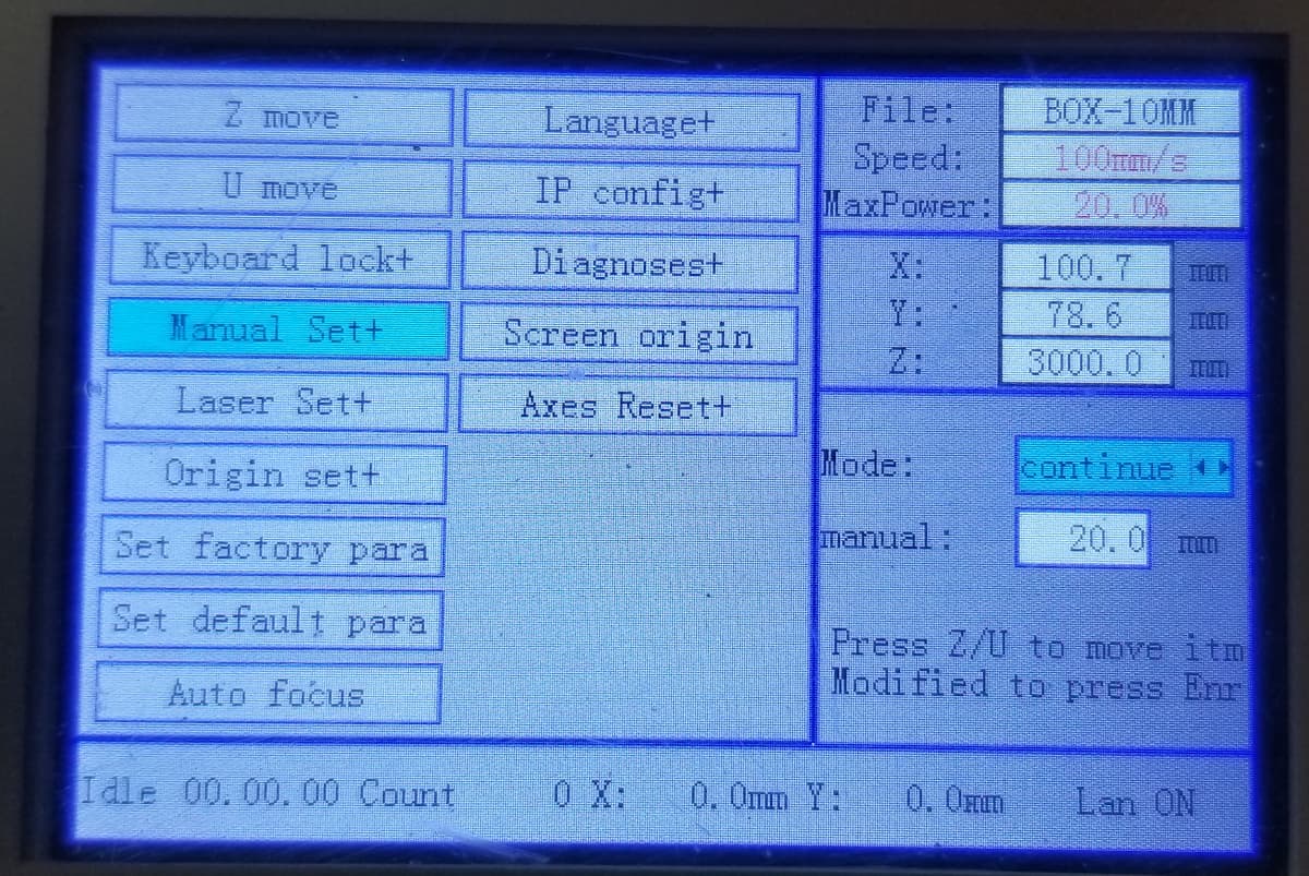

I know of no way to change the percentage out range… You can set that in a diode, but not directly with a Ruida.
My only suggestion is to measure the output of your controllers pwm (L-PWM1) at a few power levels… You don’t need the tube to lase and I’d recommend you don’t power up the lps. Set the percent power value on the machine console and measure the pwm output of the controller when you hold it down for a continuous pulse.
Through the machines console you can set continuous or pulse duration Z/U → Manual Set
It should be that percentage of 5V… I.E. 50% about 2.5V – 20% about 1V.

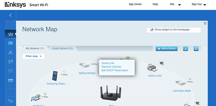

USB isn’t really a good method, it’s bit by bit… at least with a network connection it goes in packets and there is no special drivers required that aren’t required for normal tcp/ip communications.
The Ruida is great at driving the machine, but it’s rather dumb in other areas such as communications. I gave up on usb quickly. You can direct connect to your computer but you have to know a bit about networking that is beyond most users. The Ruida speaks in UDP, so keep that in mind.
The most simple way is to plug it into your lan and set it to an unused address on your network.
The only conflict could be that the router, during a reboot or refresh the router could assign a different value to the Ruida… Since a Ruida uses a static ip, and most routers have a way to bind an ip address to the Ruida mac address, which eliminates the problem.
This is the network map on my Linksys router, click on the device and select DHCP reservations.
Good luck
