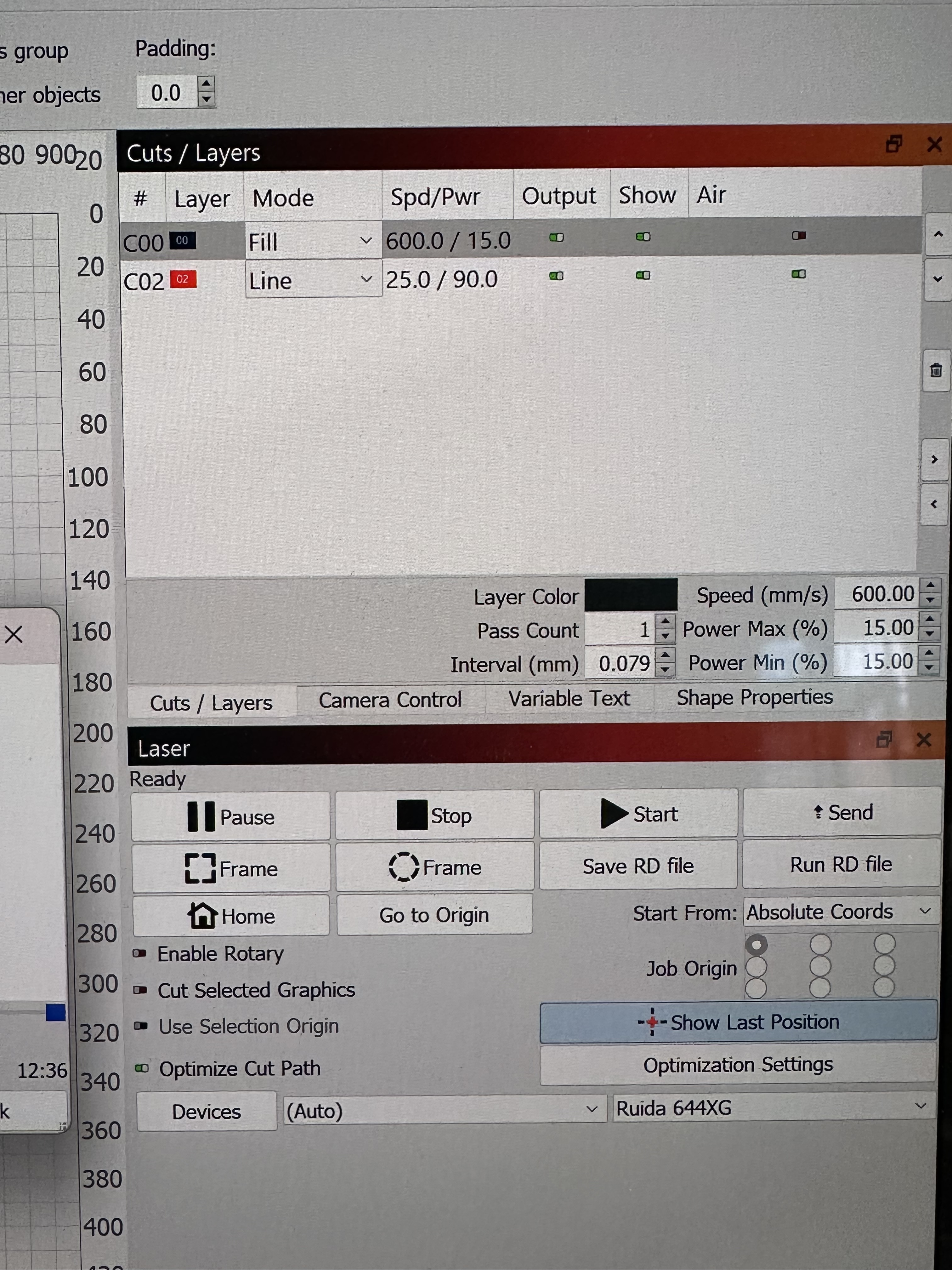

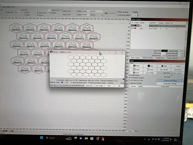

I have ‘show’ and ‘output’ toggled on but it will not show my engraving in the preview. I even sent it to the laser just to see if maybe it was a glitch or something but no engraving. If I go to another file it shows just fine so I think I’ve accidentally changed a setting somewhere but I can’t figure out where.
They don’t look grouped/selected.
See those little traveling lines, nicknamed marching ants, in your work window? You only have the inner hexagons selected. Do a CTRL-A to select everything, then Group it all.
