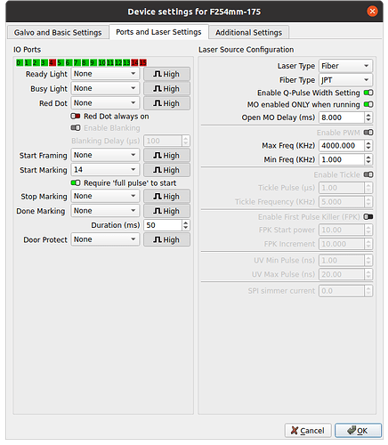

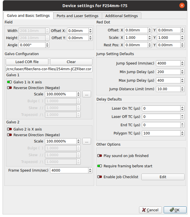

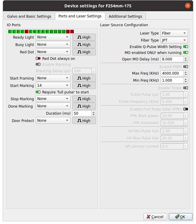

My only suggestion would be to ensure the device settings are correct… You can compare them to mine and see if there is a difference… I have a 60W JPT M7 MOPA

Thank you for the information! I tried your settings but I got the same result. It was worth a shot, though. In the end I solved the problem but I’m not quite sure what caused the issue in the first place. Just in case someone else encounters the same issue…this is what I did to solve it. I uninstalled Lightburn again but before reinstalling I deleted all the registry entries for Lightburn that I was allowed to (I don’t suggest anyone do this that doesn’t know how to edit the registry safely. Always make a backup before editing). I reinstalled the most recent Lightburn version, I selected the EZCAD2 driver just as before, loaded in my markcfg7 and whola the hole thing worked. Something was hanging it up in the registry. I’m not sure why since it was a new SSD, fresh windows and Lightburn install. I haven’t reinstalled my CO2 with Lightburn bridge so there could be another issue but I deal with that a little later.
