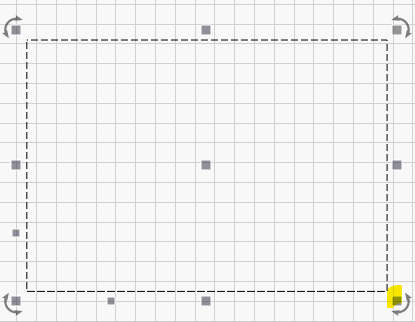

Hi everyone im looking for some help when i download a template to cut on my laser it is cutting the template out much smaller than the original file is there a easy way to resized it thanks in advance.
  1. Select shape/design to be resized
  2. Use one of the following techniques to resize the design
    2a. Numeric Edits Toolbar. Either directly entering width/height or using percentage.
    2b. resize handles on the design
Hi yes I know how to do that thanks but the original template I downloaded was actul size and when i sent it to lightburn it was a lot smaller just wondering had i imported/ sent it wrongly.

This is the file template i downloaded not sure of the original size that’s why i can’t adjust it in lightburn but when I cut it out it was much smaller
Under Edit → Settings → File Settings, make sure the SVG import DPI matches whatever the template uses.
If it’s set to 96 and the template used 72, then you’ll cut something 3/4 the size you expect.
Yes it seemed just around that size about 3/4 smaller ill give it a try again tomorrow thanks again for all your help :+1:.
