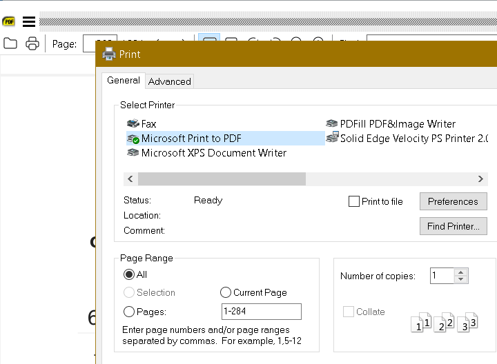

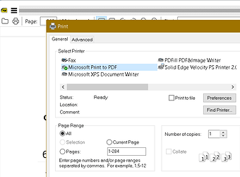

Tested with free SumatraPDF
Printed with Microsoft Print to PDF without errors.
