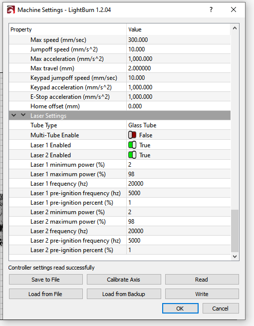

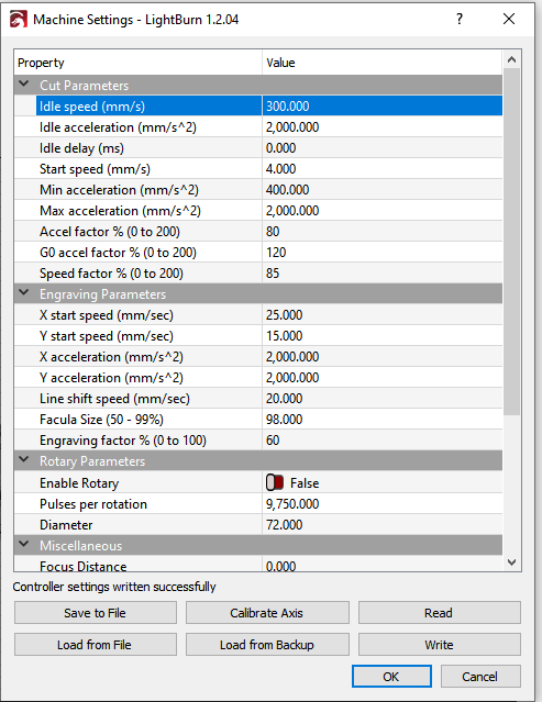

  1. if you use max/min power settings, check the start speed in the controller. It’s available for all axes. If the speed is <= start speed, you will only get minimum power.
    ॰ Yours is set to 15mm/s… if you run that or below, you’ll get only minimum power. Mine is 5.

Holy moly. I’m embarrassed at how long I’ve lived in this perpetual thought that some how I got scammed. Thank you so much. I had so much luck with projects early into having a laser, but shifted over to mostly engraving after struggling to cut. I knew I was on to something, and I’m so thankful you helped me figure out what it was! I love you!

Being able to get ~65% power at 5mm per sec has drastically improved the thickness at which I can cut. I just tested a solid 6.5mm red oak piece, a 9mm pine board, and this 6mm birch ply I’ve been cursing at for a year. All with buttery smooth results with 2 passes, assisted by 30-40psi.
