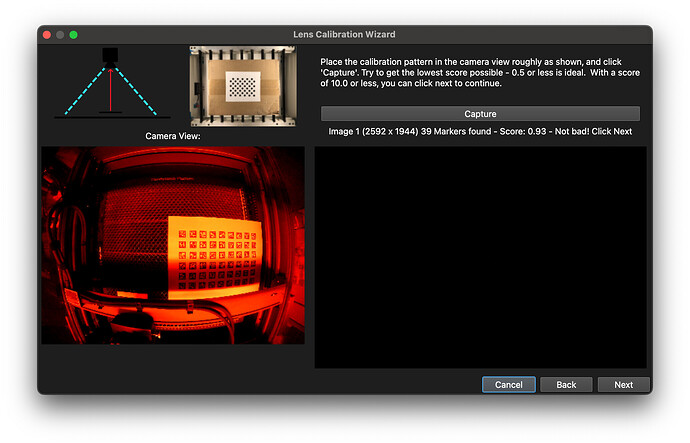

So I was using the RC 6-9 and all those versions work great with the camera on my Falcon2 Pro 22W. When 2.0 was released it doesnt work anymore. I had the issue in 1.7.08 and as per a CS rep they advised I try to use a beta version of 2.0.
Now that 2.0.1 has been released I figured I would update and see if I can get the camera working again. Same issue. I can see the camera in the main window just fine but when I try to click update overlay it tells me to Use the Camera Alignment wizard to compute the projection first.
I have done this in the older RC models and it transfers over just fine. Never have to redo the calibration.

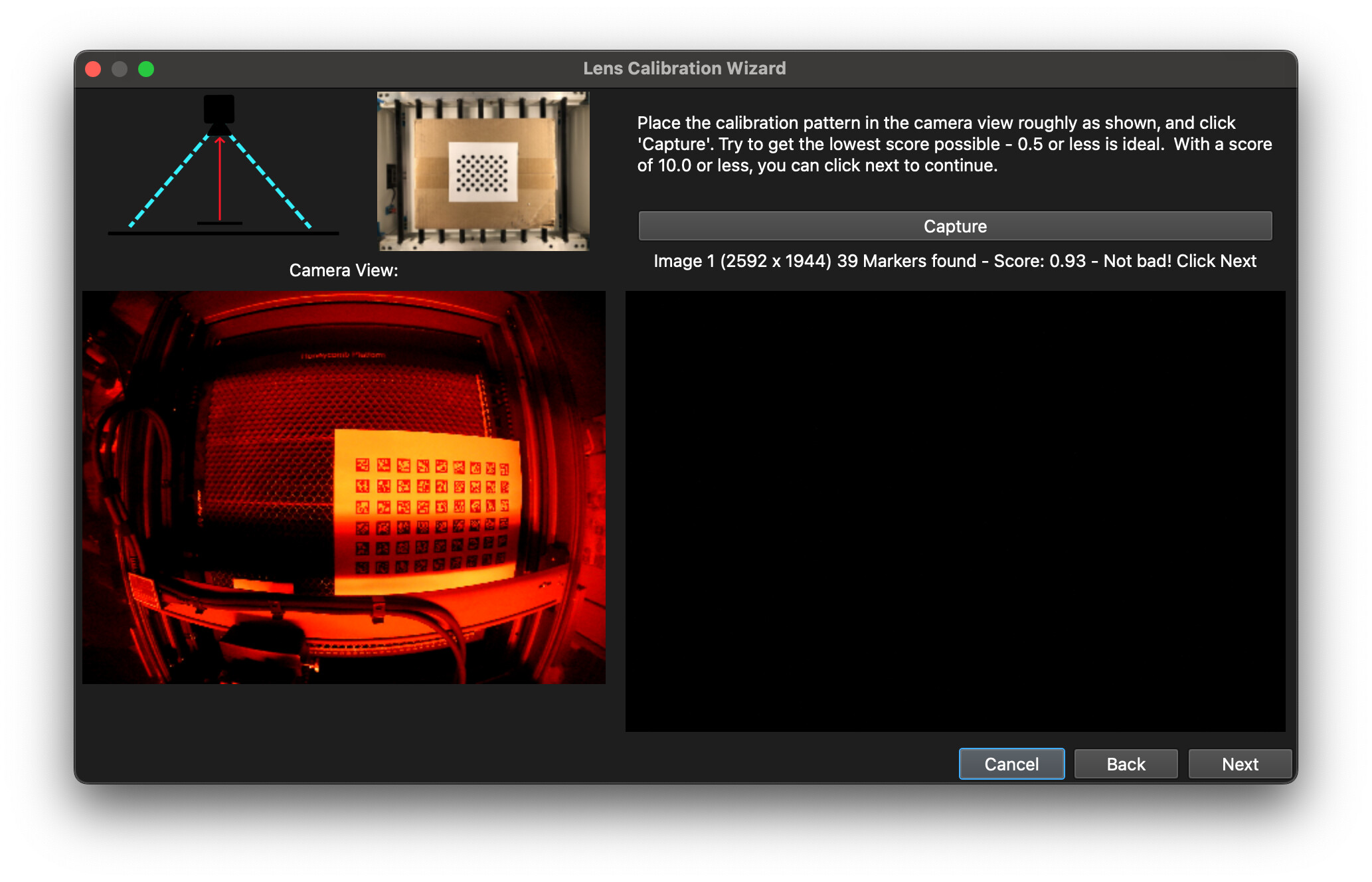

I downloaded the RC of 2.0.1 and the camera works fine. Idk what is the reason that the camera just doesnt want to work for the release versions. When you go to do the camera calibration it just shows black box where the camera would show the captured image. Even if I put one of the test papers in the machine sometimes it will capture it but most time it doesnt. I had to capture about 30-40 times to get it to say the 3rd step of the calibration process. I gave up after that.
Any idea?
