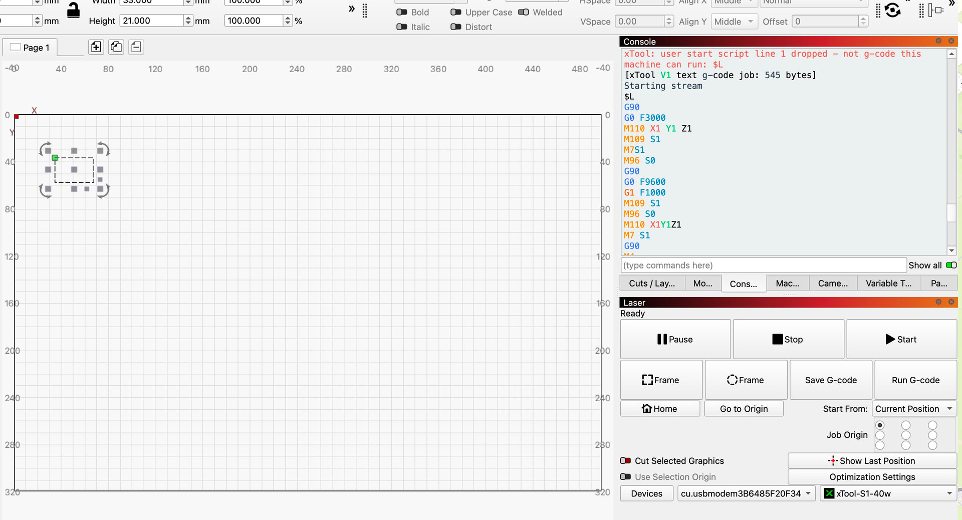

Installed and confirmed. On my XTool S1 10w, Frame respects “Current Position”, but “Run” moves the laser to the home position and then executes.

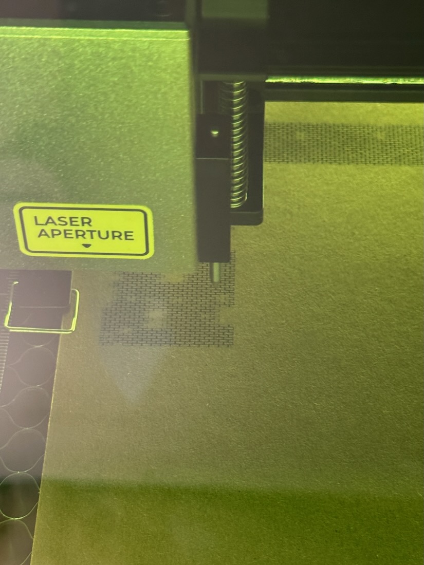

The other thing I noticed is that the laser path optimization is ‘strange’. I did a repeated (scale brick) pattern, and the laser cut parts of the pattern, moved to another part of the pattern, then moved back. It did this several times to complete the pattern. And there was ‘no pattern to the pattern’, in that I had 2 copies of that pattern, and each was cut in a different order, with the second occurrence started before the first was finished. Not the best photo, but you can see the ‘hole’ in the brick texture.
Eventually, the entire image was cut.

As for the brick pattern, check your optimization settings and make sure it’s doing the same thing as it does in preview.
Its likely there’s a method to it’s maddness, just not one you are seeing.

In my test case, I start from scratch, set Z for the material, position the head, do Frame and the outline is where I put the head. But when I do Run, the head moves to the home position and the burn starts there. So there’s very much a difference between ‘Frame’ and ‘Run’ that is at the heart of my problem.

The Start from is set to “Current Position” The EXACT sequence I do is
  1. turn on the laser
  2. select it in Lightburn
  3. load the file
  4. manually position the head to the middle of the material
  5. press “Set Z”
  6. press “Frame”
  7. press “Run”
I do NOT touch the head after Step 4.

The problem is that, as Joe mentioned, we are currently always homing the machine before running a job. So it frames from the current position, the machine homes and startes from that position.
We will probably change this for the S1 and P2. Use Absolute Cords for the time being.

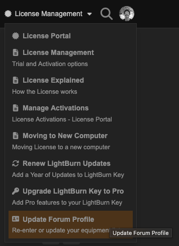

@deemery if you want to update your forum profile to show the lasers you have, you can use this link here. (It’s not in a place one would expect to find it, so no respiration at all)
Uh, when I clicked on the Update Forum Profile, it began a start over, not an update. Is that normal?
I’m afraid that Re-entering the details is the only way to update the profile information still.
