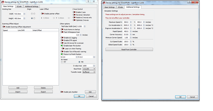

If you look at the calculated value of Overscanning in your cut settings it shows 125mm.
I suspect your work area dimensions are incorrect. Can you take a screenshot of Edit->Device Settings?
I didn’t mean for you to export as SVG. I was expecting you to save gcode and run it. But this test is no longer necessary since it’s already been proven that your laser is likely doing what it’s asked.
It did not find the sculpfun automaticly so I added it manualy, but the only dimension it asked were the size, and I entered it 410/400 and selected GBRL as device. Here is the requested image.
That looks fine. Can you save the .lbrn test file and upload here for review?
You are using the wrong units. You set the layer speed to 5000mm/sec which is 300.000mm/min. And the laser is only capable of 6000mm/min (100mm/s). That’s also why there is so much overscan.
Change the units to “better for diode” in main settings. Then try again. Additionally, 5000mm/min is still too fast for decent quality. Start with 2000-3000 mm/min and start experimenting.
