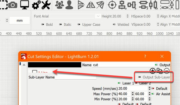

Lightburn seems to send empty files to laser
I am trying to do nothing more than to engrave a circle, my system and laser connect without trouble. preview is blank, I push start and the laser air control opens and closed and it says done, if i send the file to the controller (rdc6332m), it shows the file, but no preview… i swapped over to rd works, which i do not use, but it works flawless. am i doing something wrong?

As for the Preview and file being empty, this is due to the layer output state. I am trying to understand how this layer got into this state, but note the ‘Red’ text in the Sub-Layer name. This signifies this Sub-Layer is set to not output and appears to not allow state change. I will generate a report for dev team to investigate further.
I can recreate this state by adding another Sub-Layer, set the output for that to off, then remove the first Sub-Layer. The state of the second Sub-Layer is retained, and the Output switch is locked into the state set when created. My guess is this is similar to how this happened with your file.
To resolve, temporarily add another Sub-Layer, which should allow you to flip the state of output back to on (note the Sub-Layer name turn from red to black).
I was messing with this and that fix doesn’t work for me with that file. It also affects the layer settings when I open a new Lightburn. I had to open a new Lightburn draw a circle then reset layer to defaults for it to go back to normal.
I had the same problem. I added a sublayer and then it worked correctly. After reviewing all the options, I noticed that the color I was using was called “Text” once I set it back to default, it worked.
I noticed that you are also using a name for that color. Reset it back to default and it will work correctly.

That did it for me, thank you very much!
