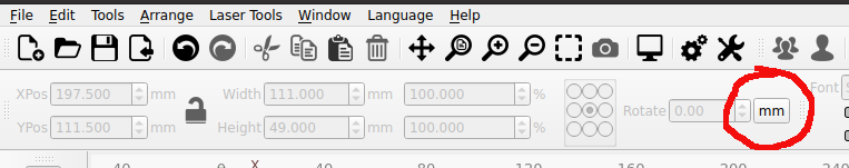

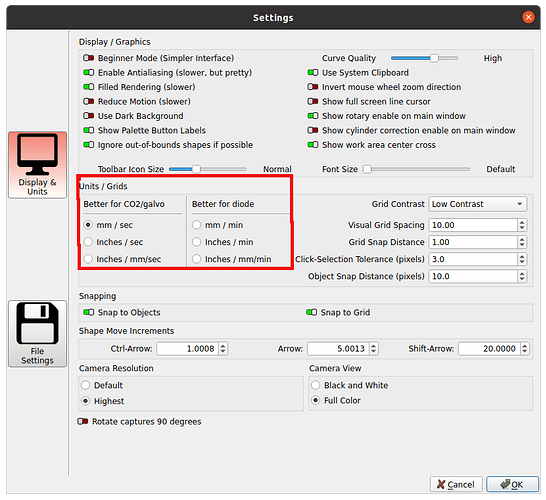

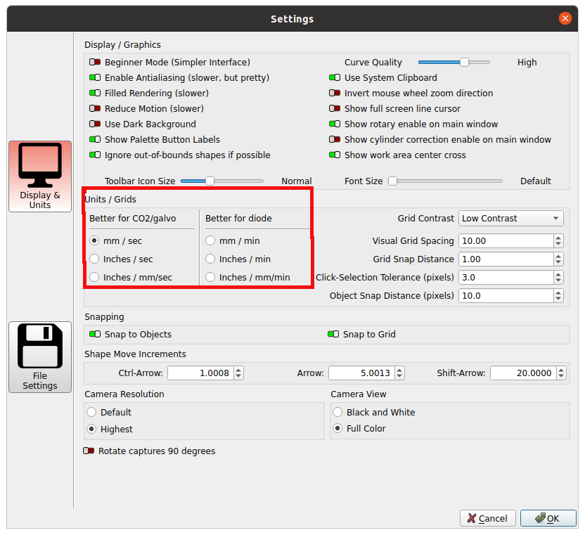

  1. a few days ago I installed the latest update (March 19-ish, 2024)…since then, power and speed settings from lightburn do not transfer to the machine, even though the file DOES transfer with no issues. For each color/type of cut, I get some random speed/power combo (like 381/20% or a speed of 1000+/25%). After much irritation, I was able to manually adjust these numbers on the controller (Ruida, there must be a better way!!), and I got some successful cuts! But I’m still kind of in trial and error mode, and I am still changing the design, so every time I send a new file to the machine, all the speed/power settings change. Is there a setting ive maybe turned off that tells lightburn to send these settings with the file?

381/25.4 = 15 - an inch to mm conversion.
As a guess, I’d say the values in the Edit → Settings that determine if you’re working in mm/m, mm/s, inches/m … might need to be examined.
Current working units are in the tool bar…

AHA! You’re a genius! I forgot that i had also changed the units right after i updated (first time i needed to use precise measurement!) Thank you thank you!
