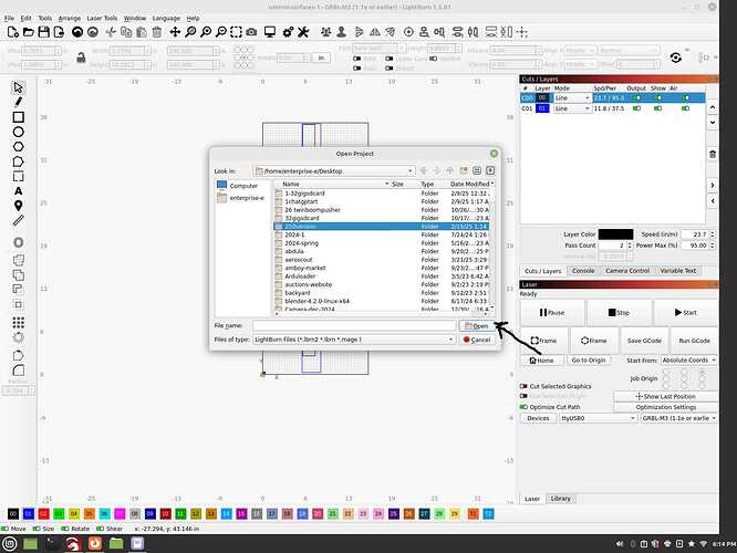

LB has been running fine for quite a while yet it started to shut down when trying to navigate to different folders and files. I just figured out the work around by using the “open” button rather then double clicking on the folder/file to navigate through.
Upgrading to the latest version did not help, reinstalling it to the latest version did not help, reinstalling it to an earlier version did not help, bypass system load on or off did not help. It opens files from the recent tool/option, it opens up additional files after you have opened up recent/option file in the same directory. Other programs are working fine when opening up files and folders so it’s not a system wide problem on my end. What is strange is that it just started happening and I did not make any changes or adjustments, also it does not matter if the laser is connected and powered up or not.

Showing the “open” button, now required to be pressed rather then double clicking on the folder.

In the screenshot you posted above, you don’t have any file selected to open, only a folder.
What happens, if I double click the folder it will open up the folder and then LB shuts down/crashes immediately afterwards. If I just use the Open button it will not do that, and it still requires using the open button once the file is selected. From here, once that file is open, I can then open up within that directory and double click on any file within there and it opens up fine. If I need to change to a different folder/directory, I have to go back to using the Open button again as explained.
