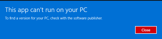

I am new to Lightburn. Recently bought a Longer Ray5 laser and want to use Lightburn, so downloaded the trial, but cannot get it installed. I have upgraded to Windows 11 Pro as I had the Home version. I checked, I am not running in S-Mode either.
When running the installation file it gives me this error:
I tried running it as an administrator, then it gives me this error:
I have read that the Visual C++ 2015-2022 Redistributable could be the issue. So I uninstalled all and reinstalled the one’s that were on the lightburn form as suggestions.
I watched a video about possible problems of why it could say “This app can’t run on your PC”, I have right clicked and gone to properties and checked compatibility, I have changed to developer mode, have switched off “reputation-based protection”.
I just don’t know what try anymore. Someone please help. Would really like to get started.
To what folder have you downloaded the installer? The location in your second screenshot is highly unusual.
Can you locate the file in Explorer and take a screenshot showing the full path to the file?

This is the file path. “C:\Users\andri\AppData\Roaming\Microsoft\Windows\Network Shortcuts\LightBurn-v1.7.08.exe”
I tried saving it to the “Program Files” but then it tells me to I don’t have permission do that. I have full administrator rights and have managed to download an install all my other softwares. I can manage to copy it into the “Program Files” location though. “C:\Program Files\LightBurn-v1.7.08.exe”. But when I run it, gives the same error screen.
Funny thing is… I managed to get an older version and that installed perfectly. It is version 1.3.00 though. I am planning on buying the version after the trial expires, so that concerns me, what’s going to happen when I have to upgrade.

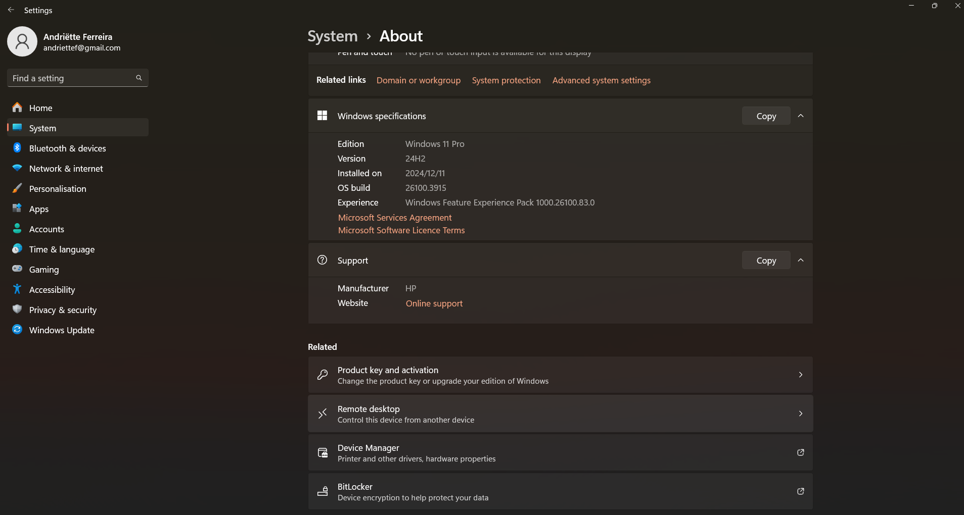

For some reason the top and bottom of your screen is cut-off and I can’t seen all the details of the installation.
However, can you try these steps:

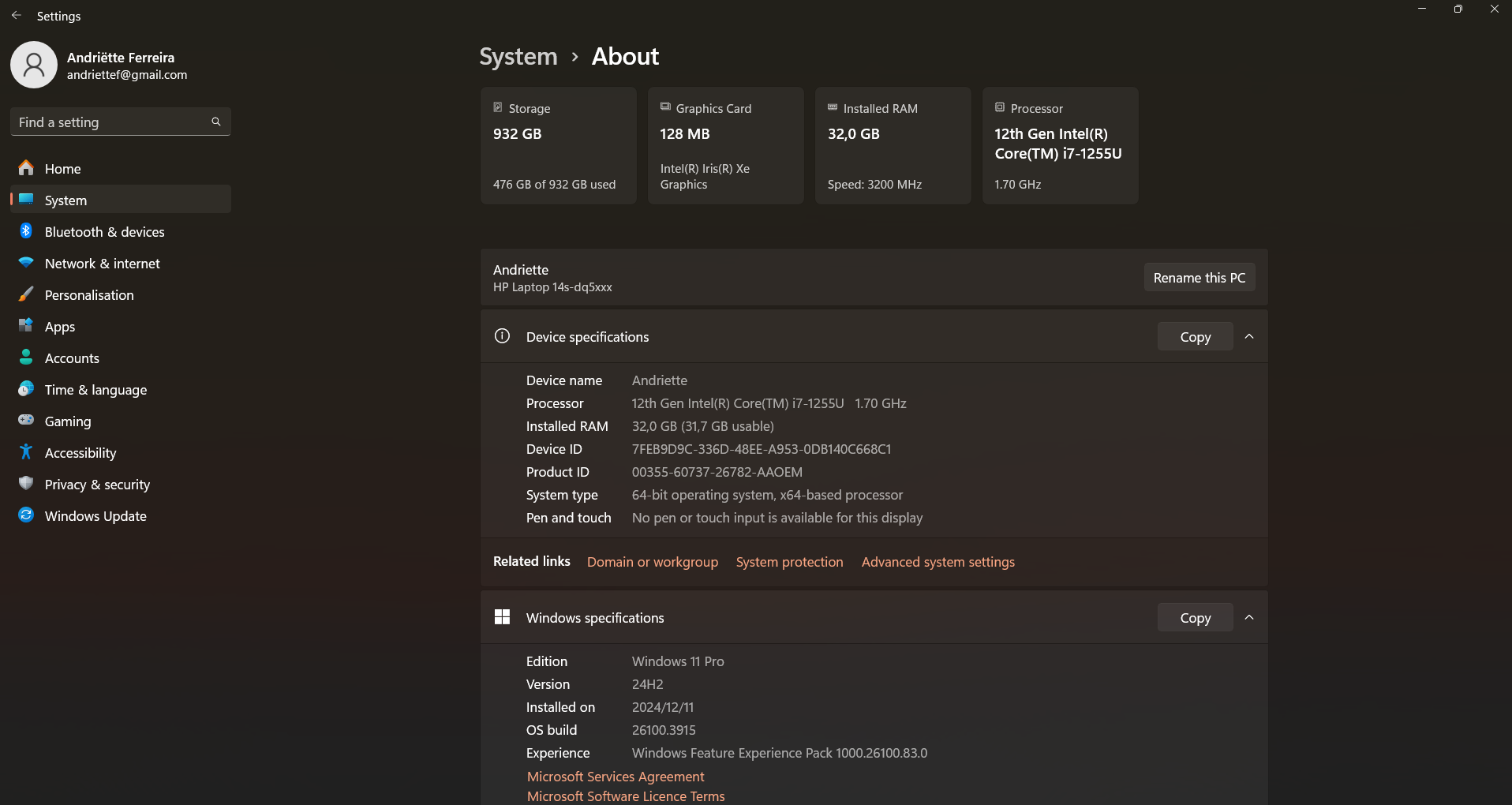

  1. Go to Settings->About and take a screenshot
  2. Instead of clicking on “This PC” for download location, click on the “Download” folder. Then try installing from there. Does that change anything?

Hi there
Here’s the screenshot.

Saved it to the download folder and tried installing gives me the same red warning block.
Can you try running as Admin from the Download folder? Capture the screenshot of any resulting error message.

It looks like to me you have a system corruption of some kind. This isn’t simply a permission issue or similar.
Try running this in a CMD prompt with Admin privileges:
sfc /scannow
If that doesn’t work, I suggest attempting to do an image recovery. Check here for details:
If you these commands identify issues and are able to repair the system then try rerunning the installer.
