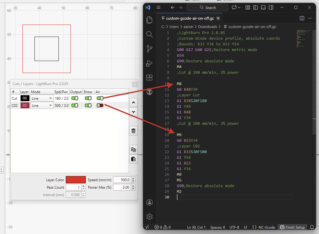

Lightburn software mistake
Yes, I have the A1 Pro (the newer one with the display on the side).
Creality’s .lbdev file for the A1 Pro uses the GRBL-LPC flavour.

Comparing it with your .LBZIP, tells me, you used the settings from the file " Creality Falcon2 Pro.lbdev", but added the M8 command to the End GCode.
Am I correct in understanding that you added this code later, in an attempt to solve the original problem?

I’ve transfered your settings to a new device, using the Custom GCode device type
Drop this file in the workarea to add it:
Creality Falcon2 Pro Custom GCode Converted for Ernst.lbzip (1.8 KB)
It creates a clean-looking .gc file that should not throw any errors.
custom-gcode-air-on-off.gc (376 Bytes)
Run this by selecting it from here:

The code order is now perfect. I can now use the AIR alarm function again. $153=1 instead of 0

To be honest, I do not understand the difference here. This G-code also shows the M9 command BEFORE the laser is turned off, right? So that’s been precisely the issue this was all about. Your profile doesn’t change it, and the laser should throw an error again. There is no difference in this G-code from the one I posted. Could you point me to the change? Maybe I’m just blind :slight_smile: I really like to understand it :slight_smile:
Honestly, it was a wild guess.
What bothered me (and possibly the Falcon) in the code from the regular GCode device type was the extra G1 S0 encapsulating the M9 command.
I have no idea how Creality’s “Airflow alarm” works exactly, and which circumstances trigger it. It might be timining dependant. There’s not much to go about on their troubleshooting page
Because, we don’t expect the laser to complain if we send it a G0 or a G1 after turning off the air assist with the M9 command.
IF the controller required a delay after turning off the Air Assist, we could add a Dwell to the “Air Off” command.
The GCode device type allows that:
We found that some Falcons have a firmware setting that sets a delay for when the Air Assist turns off with an M9 command.
It’s at 20 seconds by default.
Entering this command in the console sets it to 0, so that the pump shuts off immediately, as expected:
$152=0
