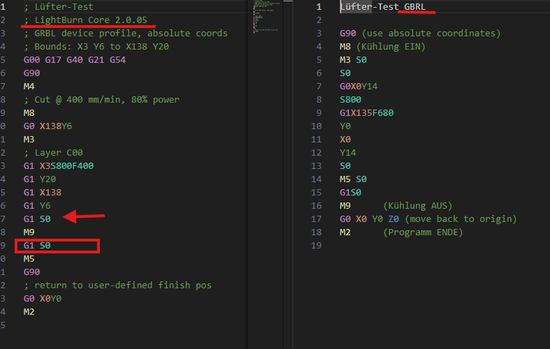

When I cutting with LaserGRBL, the G-Code commands are issued in the correct order.
First , the laser is switched off with S0 and M5. Only then ist the cooling switched off with M9.
LightBurn is doing this incorrectly!
Here, the cooling is switched off before the laser. This causes an airflow alarm, Error 4.
Additionally , the Creality Falcon2 switches the laser module from normal mode to precice mode!
The laser then no longer operates at a maximum of 40 watts, but only at 22 watts!
The laser must then be manualy switched back to normal mode on the laser module
Can you show us the GCode of both programs?

@hobbysaeger Thank you for your clear report and sending us the GCode files via email.

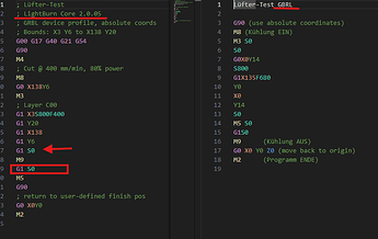

Here’s a screenshot of both codes:
I believe, it’s the second G1 S0 that throws the airflow alarm you mentioned.
I’m not sure why this command is being sent before and after the M9
Maybe, @goeland86 has an explanation?

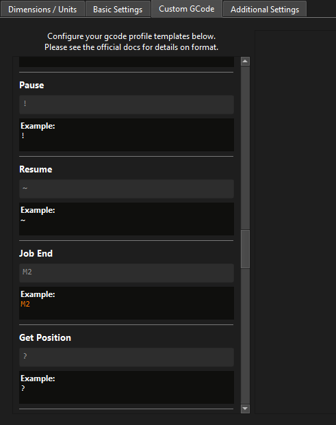

You can use the custom gcode tab in the device settings to modify the end of job squeegee to suit your preferences /needs. I still am not clear what’s causing that error message, because G1 S0 on older grbl was the best way to set the power to zero, and M5 would disable power to the tool as a whole.

I mentioned you can, and should, modify the Job End section of the Custom Gcode profile:
I don’t know if your default is M2, or something else.

I think he is talking about this (generated with the standard grbl profile):
; LightBurn Pro 2.0.05
; GRBL device profile, current position
; Bounds: X0 Y0 to X101 Y155
G00 G17 G40 G21 G54
G91
M4
; Cut @ 600 mm/min, 90% power
M8
G0 X0Y85
; Layer C00
G1 Y70S900F600
G1 X101
G1 Y-70
G1 X-101
; Cut @ 1500 mm/min, 80% power
M9 <===============================
G0 X29Y-15 <=======================
M3
; Layer C01
G1 X71S800F1500
G1 Y-70
G1 X-71
G1 Y70
G1 S0
G1 S0 <============================
M5
; return to starting pos
G0 X-29Y-70
M2
These two should be sent the other way around. The AA is turned off first, then the laser is turned off. I can follow the arguments and suspect he is right here. It’s only that the standard grbl firmware does not have the functionality to check the AA status while running. It simply doesn’t care. So to speak, the Creality firmware is more advanced, and the safety check is correct to throw an error, though the next command should make the error obsolete, but the firmware won’t do a lookahead before throwing it.
(be aware in the gcode above, the second object didn’t have AA activated).
