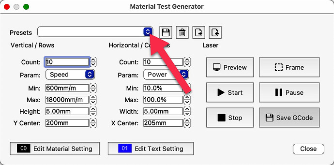

Typically you can save the settings within the Material Test then recall them again, in the Material Test. I have many saved that way.
Here’s what I mean…
I save the presets by clicking on the disk icon
Give it a name
Next one
Give a different name
Now I can click on the drop-down menu…
And see the saved presets
I use a Mac. Windows machines may look slightly different.
I can save and run the test from inside lightburn. But how do I get the file to share? When I save it light burn cant recognize it to open it afterwards. I use a mac too
As I understand it you can only open the file from within the material test generator using the ‘import preset’ button

You can export your test file within the generator and save it to where you want and the import it back from within the generator.
Thats correct… So this file can only be used in lightburn??? Correct???
That’s what I believe
