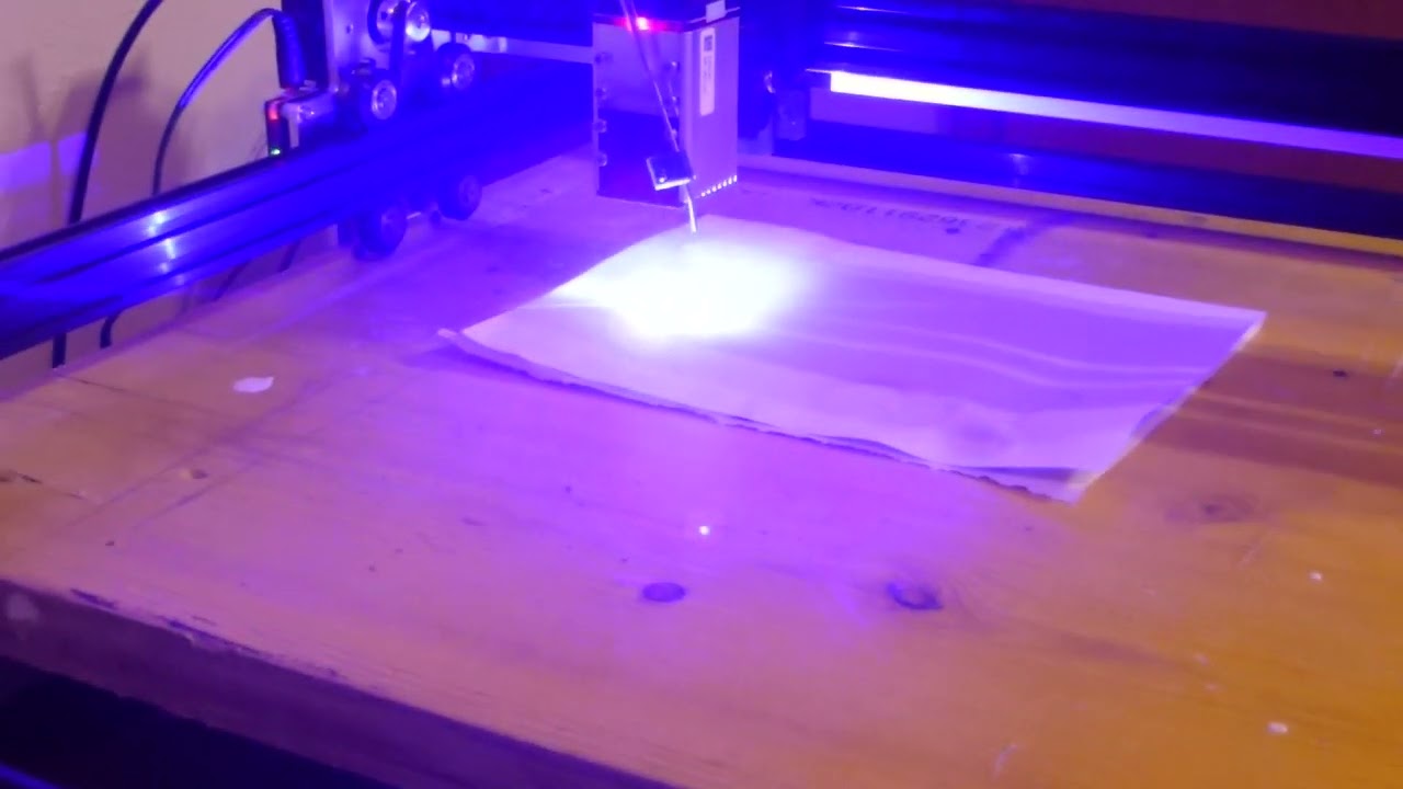

Hello, I have Neje 3 Max, Lightburn software. I chose the dxf file to cut, the Lightburn software only outlined the contours of the cut element. Unfortunately, he did not cut the item. There was no message in the Lighburn software.

What material are you attempting to cut. It appears that you have 20% power set in an earlier post.
communication ok, is other problem. Link to the video
Hard to tell from the video but a few notes:
  1. you may not be in focus. Make sure the laser focus dot is as small as possible.
  2. it’s not clear what material you’re burning to but try swapping out for something like cardboard or darker cardstock. White office paper can actually be tricky to burn on properly.
  3. you are moving much too quickly for the given power. Slow down
  4. your power is too low for the given speed. Increase power.

    Yes, I understand. Unfortunately, the laser does not burn - that is a problem. does not cut
It does not cut because of the things I addressed above. If you make those corrections it will likely cut/burn.
Have you made any adjustments?
yes i decreased speed and power. It’s ok. Thanks a lot. Regards Pawel
