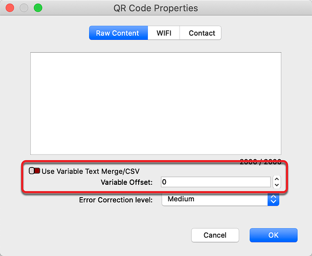

LightBurn does not currently provide Barcode generation, but we do provide the ability to generate a QR Code for labeling. The ‘QR Code’ generator includes the ability to add ‘Variable Text’ as part of the QR Code, creating an integrated labeling system to produce as you describe.
QR Code Production is covered here:
Can you confirm that QR Codes work with Serial numbers? I was under the impression that they only worked with Merge/CSV.
Yes @berainlb, you are correct. I could have been a bit clearer in my description. The QR Code generator leverages the Merge/CSV File Variable Text feature. In this case, one would build a list of serial numbers to be used when the QR Codes are generated.
