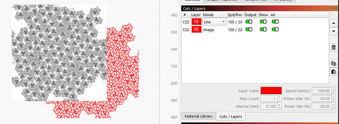

I’m trying to trace a image by right clicking it and then trace image. After is get it set like i want and click OK. The Trace Image window disappears. and all i am left with is the original Image. The trace image has not been saved. It used to work where it would save the traced image over the original and I could move it and delete the original. What setting have i change and how do i get it back. PLEASE HELP. Thanks
Perhaps the layer with the traced image is above the layer with the image, in which case the image will be drawn after the trace and cover it up
Make sure your selected layer is set to SHOW on the cuts and layers window.
