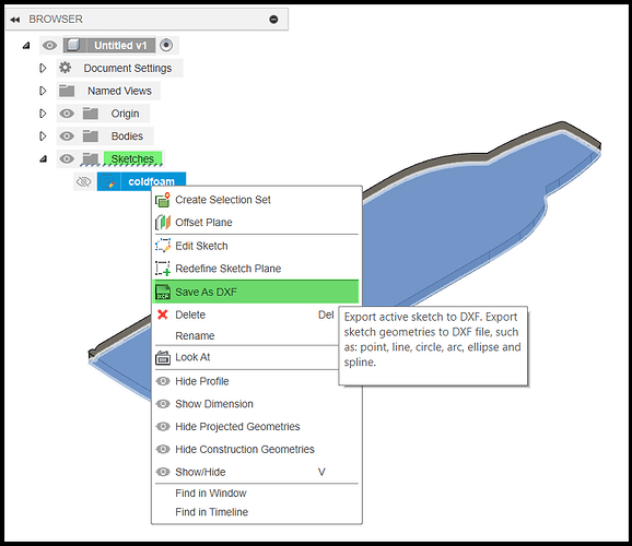

I was unable to open the DXF file in Draftsight and Fusion 360. The DXF is ASCII, but contains ASM data that refers to the 3D model within Fusion 360.
If you want to export a Fusion 360 DXF that Lightburn can import, select the sketch in Fusion 360, right click, and then Save DXF. This creates a 2D DXF that Lightburn can import.
Thank you very muchi!!!
Thank you very much my friend, the problem has been solved perfectly!
