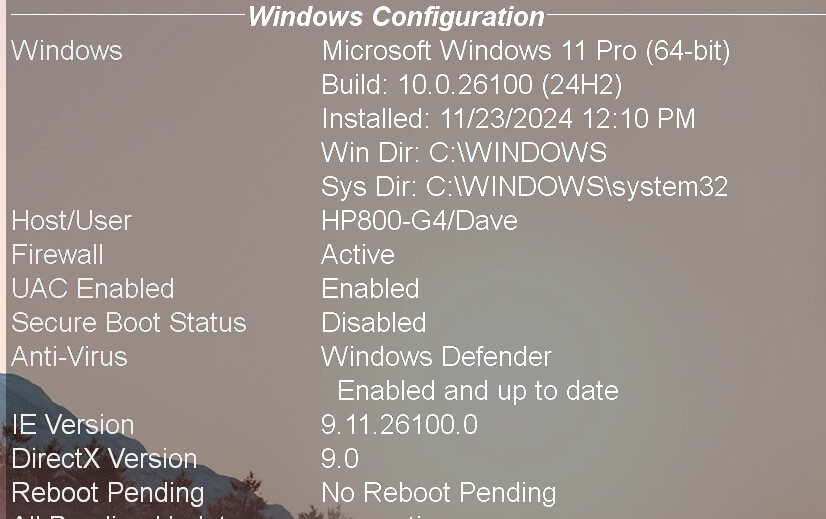

I am unable to get the New 2.0.0 RC7 to run.
Installed and started, the splash screen appeared then disappeared then nothing.
Task Manager does not show it in memory at all.
Uninstalled, deleted the directory then reinstalled and same issue.
My 1.7.08 is still installed and runs fine.

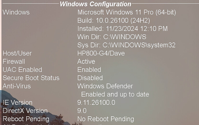

More Info from Windows Event Logs after trying today:
Summary
Faulting application name: LightBurn.exe, version: 0.0.0.0, time stamp: 0x683e0d69
Faulting module name: LightBurn.exe, version: 0.0.0.0, time stamp: 0x683e0d69
Exception code: 0xc0000005
Fault offset: 0x0000000000174be3
Faulting process id: 0x22AC
Faulting application start time: 0x1DBD975CBB60336

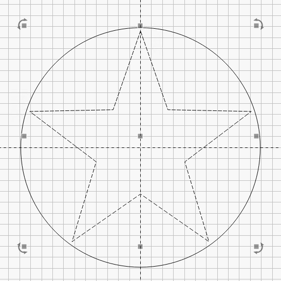

Centering 2 shapes (align vertically and horizontally) doesn’t do what I expect. I draw two stars, one a single and one a double star, to make some sort of Christmas decoration. Here I’ve aligned them manually, then selcted both and clicked on the align V and H button (top line of icons). The centers do not coincide. Same happens with circle and star.
That’s because LightBurn defines the center of an object to be at the midpoint of its bounding box, which may not be at the geometric center of symmetry.
Both the circle and the star have their geometric centers at the middle of the workspace, so the points of the star are equidistant from the circle:
However, the star’s selection handles and bounding-box center point are offset upward, because the top point of the star “sticks up” farther from its geometric center than the bottom points.
I usually draw a big circle on a tool layer from the geometric center of an odd-vertex polygon, group the circle and the polygon together, and then snap the circle + polygon to wherever it should go. Because the circle defines the (grouped) bounding box, its center snaps to the right place and the group carries the polygon along for the ride.

I realised this - which was why I was careful to say ‘Not what I expect’. and it probably isn’t what most people would expect to happen either.
True, most people would expect what you did, but we are both schooled now. Looks like a detail to add to the documentation.

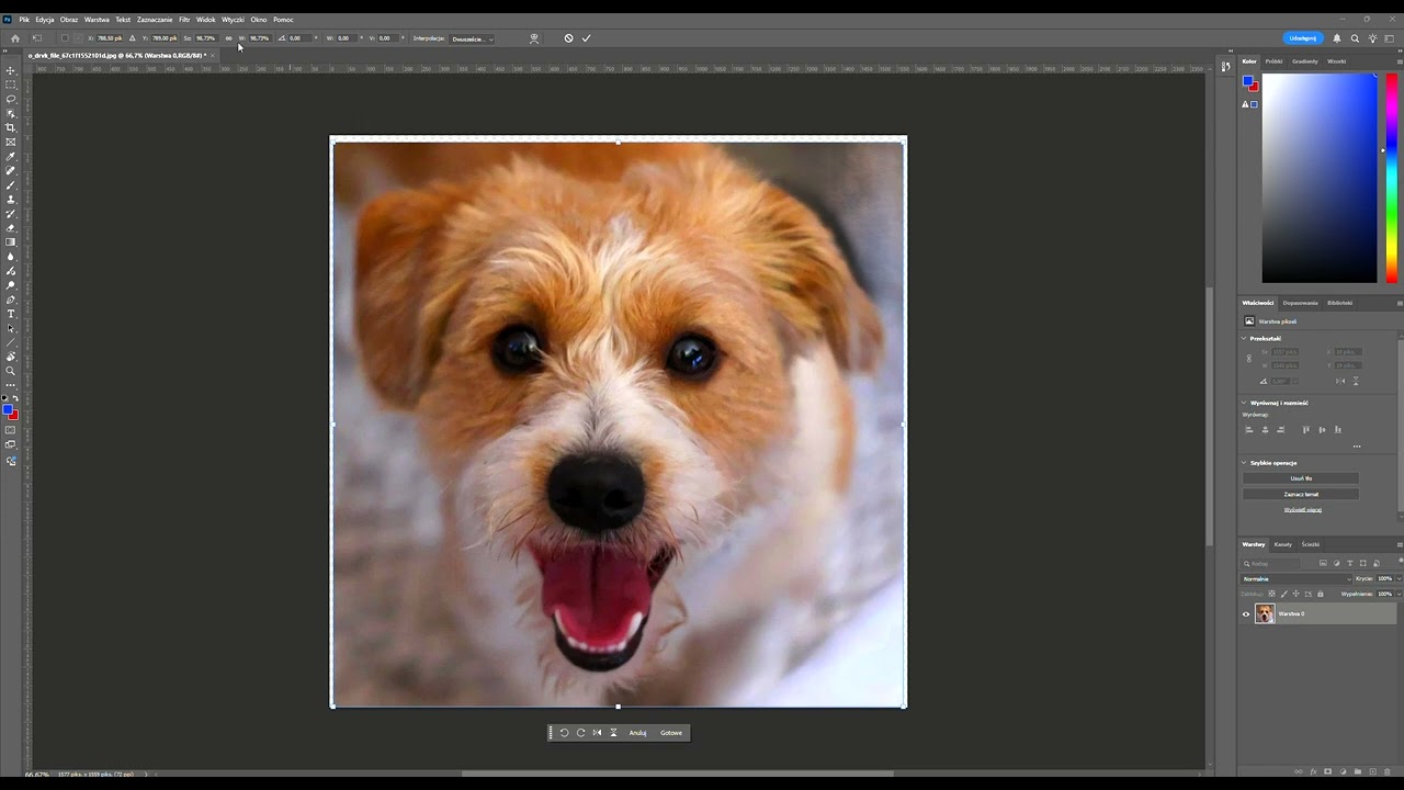

Currently, when you want to resize an element and try to do it by dragging from the center (not from the corner) you always get an element that will be distorted. In PhotoShop this is solved differently - the user has the ability to lock the aspect ratio so that the scaled element is always consistent with the original proportions. I really miss this solution when arranging elements on canvas.
Video:
corner grab will expand/shrink proportionally. no need for a lock
Resizing by dragging a corner aligns the element to the opposite corner by default, or to the center when holding the Ctrl key. However, if we want to align it to the opposite edge (not the corner) and maintain proportions at the same time, there is currently no way to do that (at least none that I know of). Yes, it’s possible to achieve this via the “Docking” menu or by manually entering the dimensions—this allows alignment to one of nine possible anchor points—but these methods are not always time-efficient for us. Adding a keyboard shortcut, even just one that enables proportional scaling from the center while dragging, would significantly improve our workflow efficiency.
