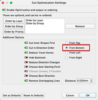

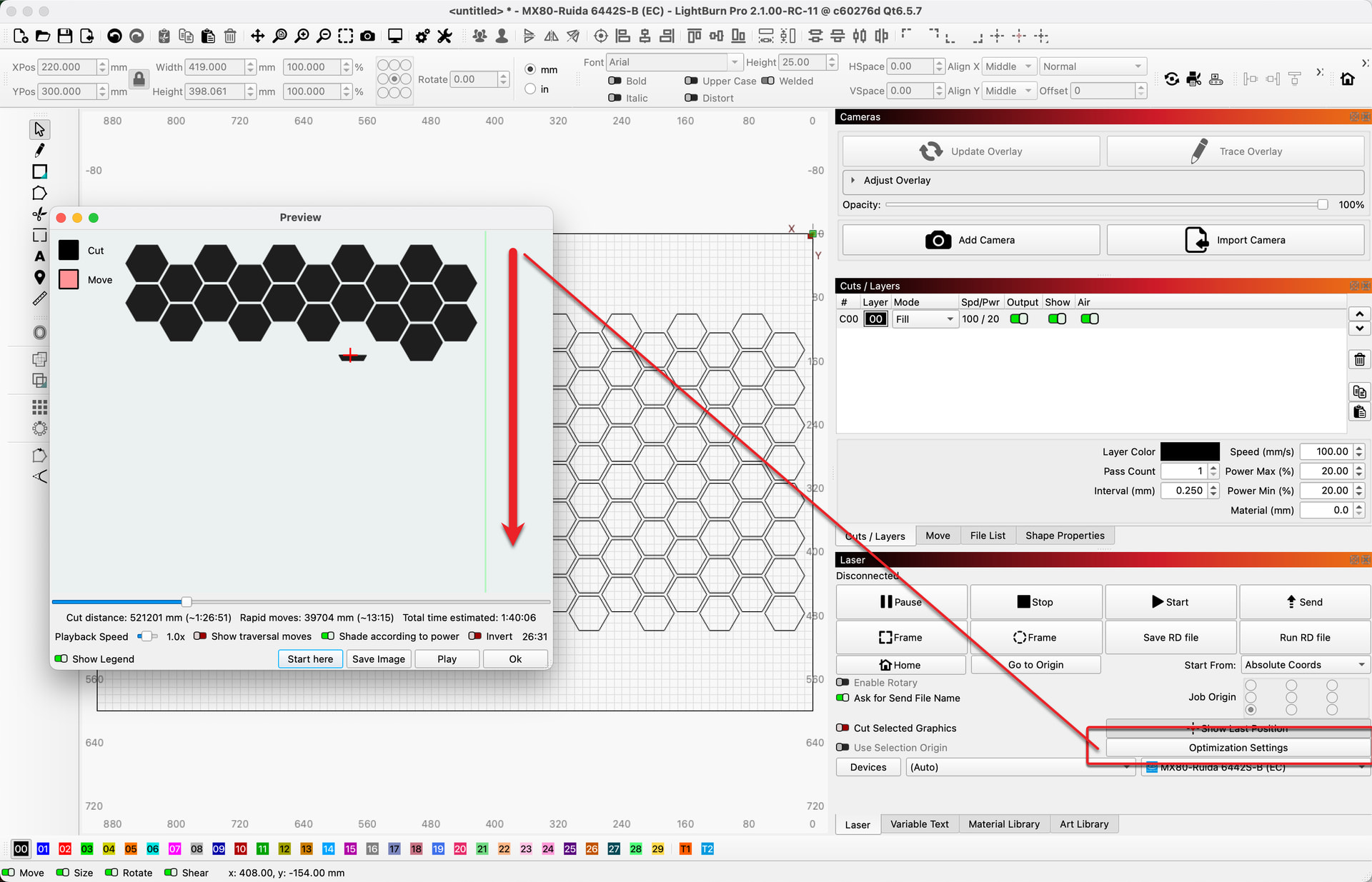

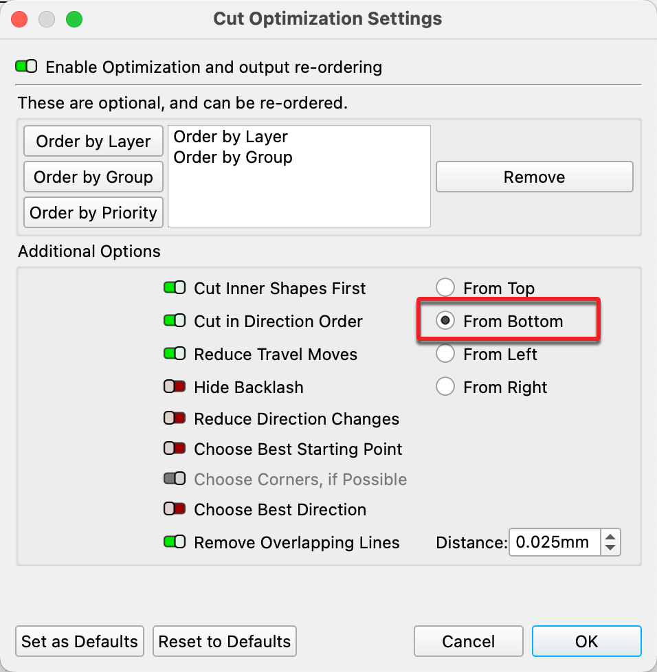

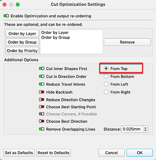

Another option for recovering a job that was interrupted is to run the job again, but this time change the direction of the production. If the original job was processing from the front of the laser to the back, change that so the job is produced back to front and stop the job when the second run meets the first. Controlling the direction of job production can be found under the ‘Optimization Settings’ in the ‘Laser’ tab.

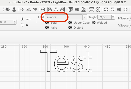

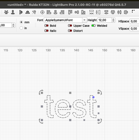

Under Mac OS, “Favorite” is still the default font at startup and is also displayed as the active font.
Thanks @bernd.dk. What is shown as active with the text selected? We have not been able to reproduce this behavior here with each report of this you have shared. We continue to hunt, as you are clearly having this happen.
It shows “Favorite” until I specify a random font. When I click the mouse in the work area, “apple system font” is displayed.
When I save a file with a specified font and restart LB with this file, the font will show “Favorite” again.
