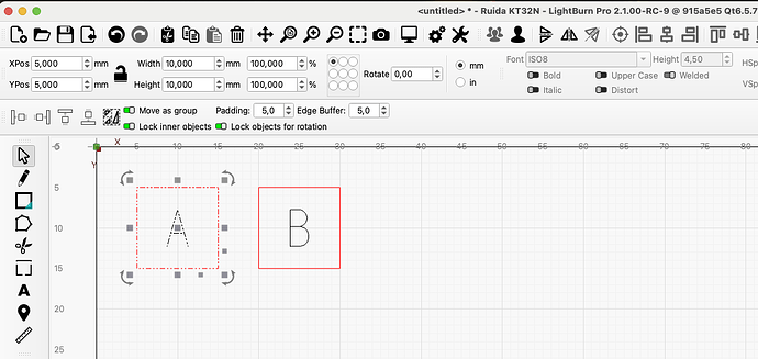

When docking a single shape to e.g. top left, with “Padding” set to 5mm, shouldn’t the X and Y position show x=5 - Y=5? When adding additional shapes, they only dock in one direction with 5mm, (but also with the origin error of 5mm).

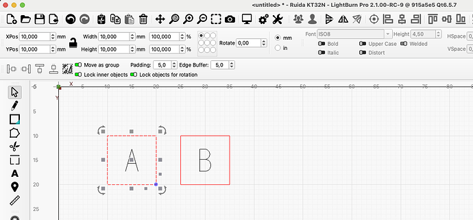

In image no. 2, the 2 shapes are in the position I would expect them to be.
