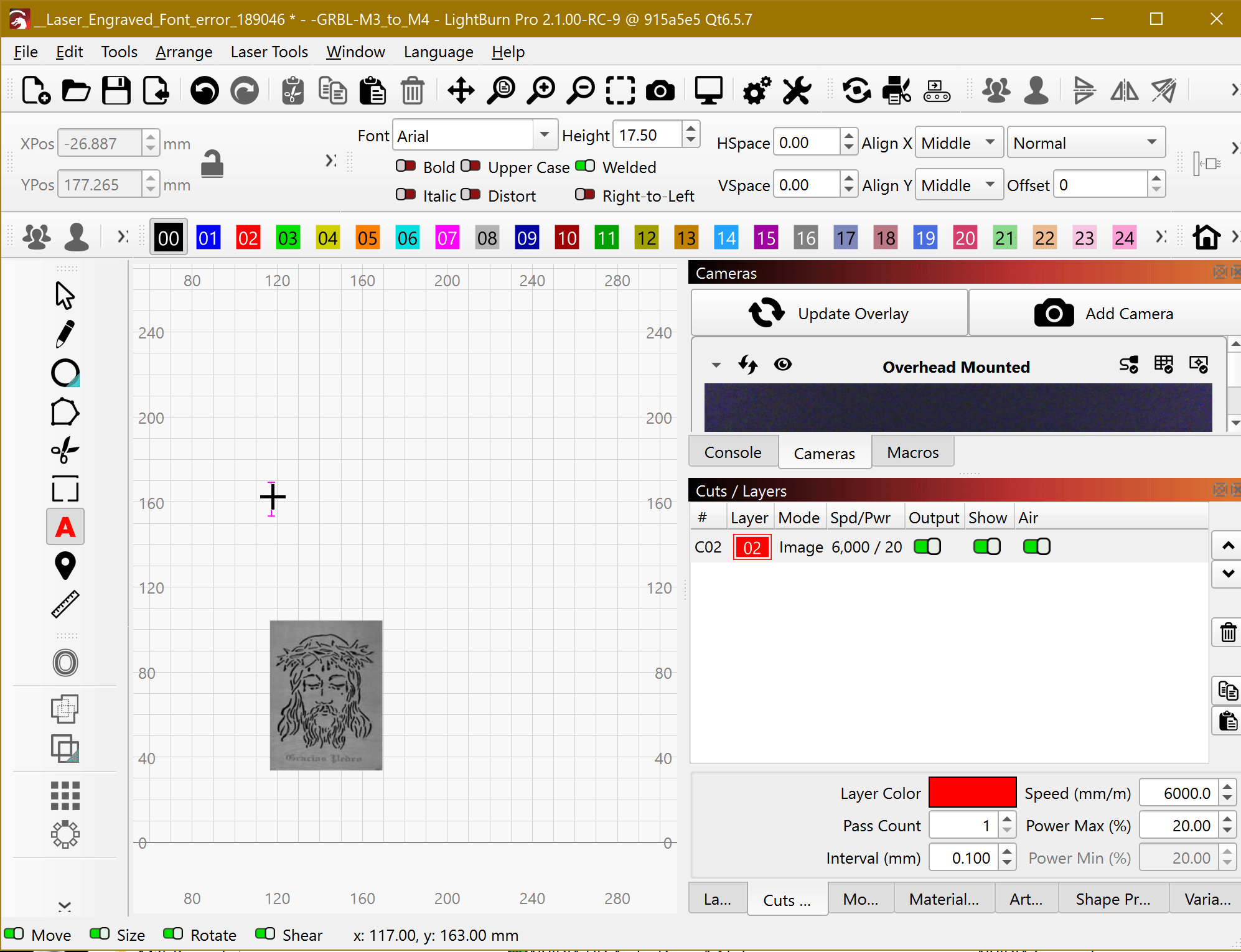

If I have an image and then write some text, the text only shows after I click somewhere, in 2.0.05 same project this doesn´t happens.
explorer_FYb5VCpAHk
__Laser_Engraved_Font_error_189046.lbrn2 (86.6 KB)
Just opened your file and also tested with a new project file on a Mac, yet I’m not seeing the issue you are clearly showing. Next up, Windows.
Can you reproduce this behavior with a different or new project file on your end, @parsec?
Sorry, original file Win10 desktop.
Now on a Win11 laptop repeat the behavior with same project.
With a new project happens the same if I type text after dragging an image.
My vote is that Lightburn is corrupt and needs a fresh reinstall.

I’ll try starting it again and wait longer.
I can reproduce this if “Laser On while Framing” is turned on.
The controller does not properly respond with an OK message after executing the command.
We expect it to do so in accordance with GRBL standards. Since we are not receiving the expected response from the controller, LightBurn assumes that the laser is still busy.
I’ll see if we can tweak the WeCreat Flavour to ignore that.
As mentioned, we added this to work around some other firmware shortcomings.

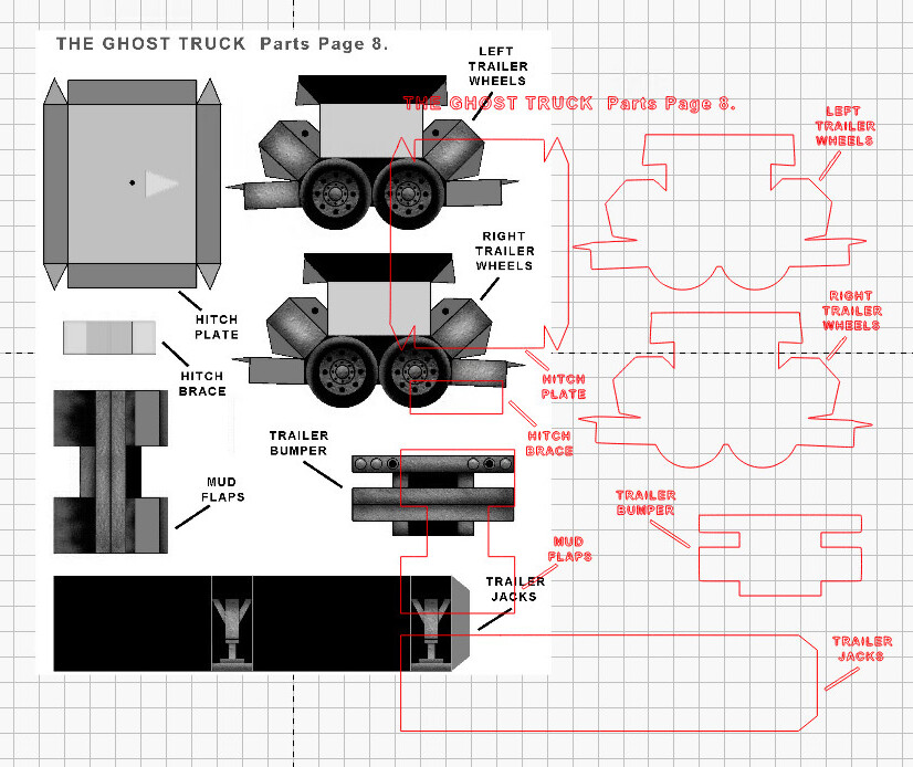

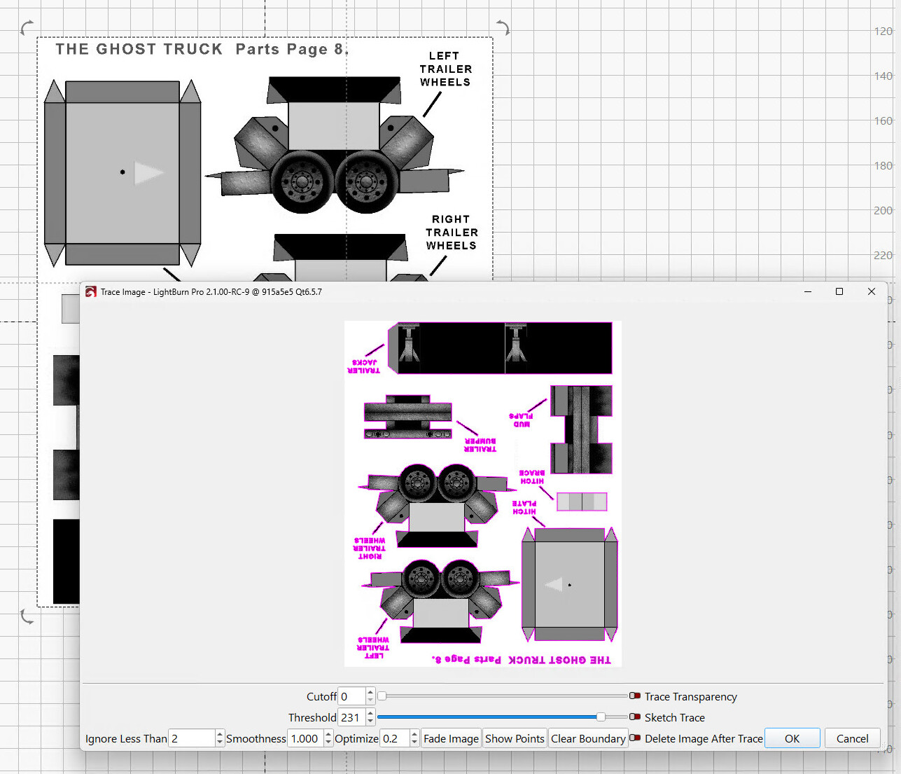

In both 2.0 and 2.1 RC9, importing a page from some PDF files, then tracing it produces a preview rotated by 180°:
Oddly, the final trace comes out OK:
This is almost certainly a corner case where the image file is inverted and the PDF orientation is also inverted, but …
That’s a fun one! I can definitely reproduce it with this PDF.
I’ll create a report to look into this.
Thanks for reporting!

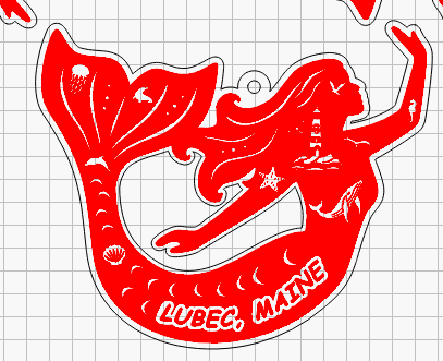

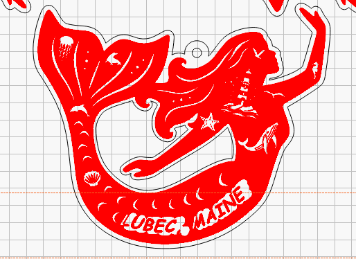

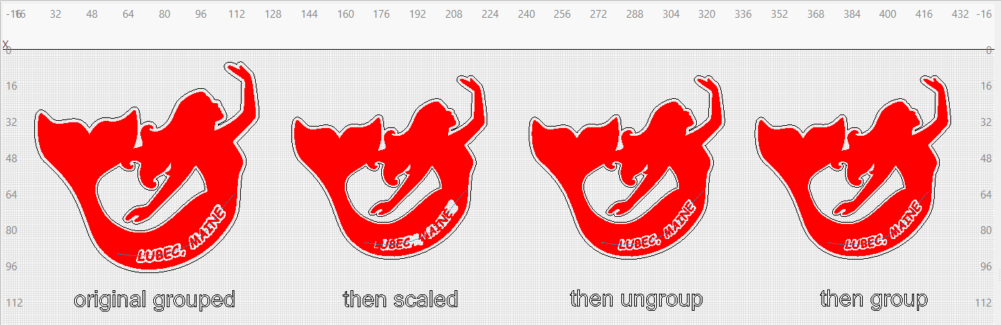

I noticed that with RC9 and earlier, when I apply a scaling operation to a grouped object that has text, the offset path around text on a path doesn’t scale until I ungroup the object. I then regroup and everything’s fine.
After scaling grouped object down
After ungrouping it:
Thanks for reporting this, @kirkilj. I can clearly see what you are describing. I have been poking, trying to reproduce this unexpected behavior based on your wording and not finding similar results. If you are willing to share, I would like to take a closer look at this project file. You can post here or send to support@lightburnsoftware.com and reference this post for context.
I think this is just a case of trying to put paths on an image layer, and LightBurn bumping said text to a new layer when input.
Can confirm this behavior, @Colin, thank you. :slight_smile:
