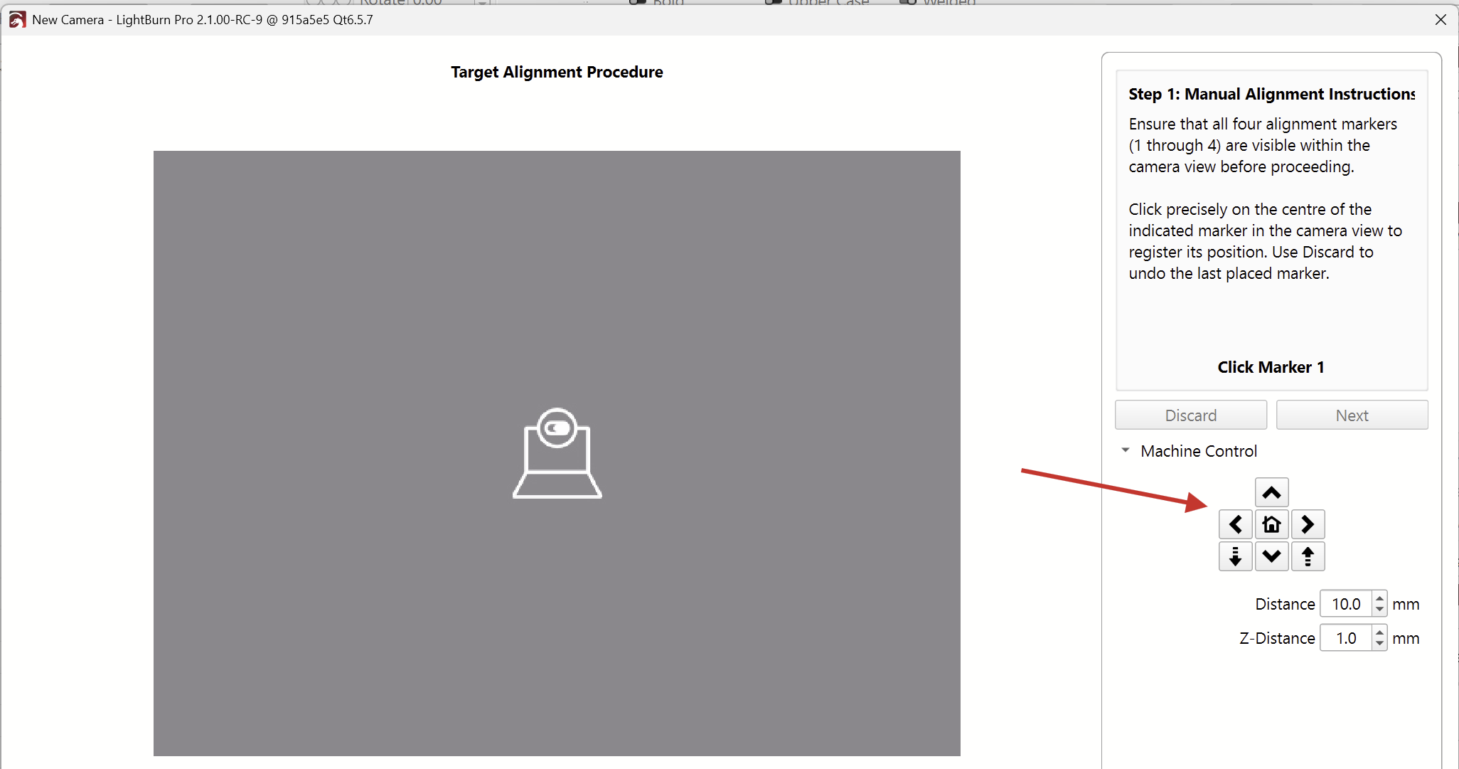

With 2.1.00 RC-9, when I try to perform the manual alignment where I need to click on the image at the 4 intersection points, the laser module blocks the view of one of the points, so there’s no place to click on screen and there’s no controls to briefly move the camera out of the way to click the point. I did this on an xTool S1 with a custom camera mount on the underside of the lid in the center of the work area. I used the laser cross-hairs to assist.

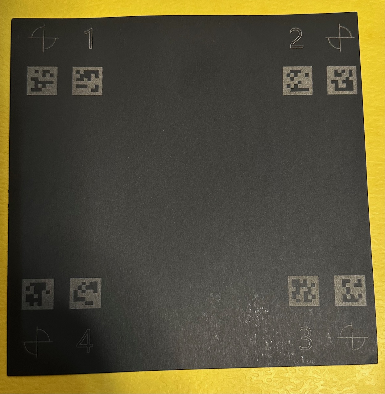

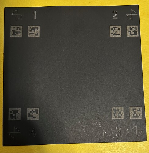

i have a fiber laser and i use to calibrate my camera using black paper.
when i want to calibrate my camera using “automatic alignment”, the software don’t see the qrcode…

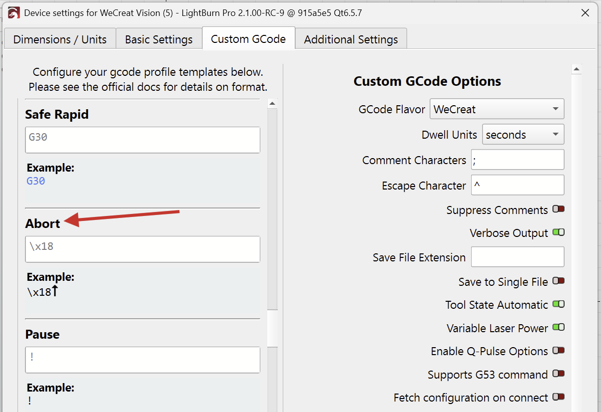

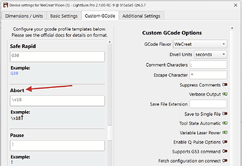

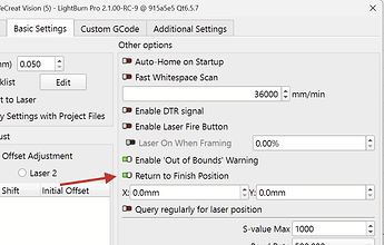

Pressing the “Stop” button sends the controller the “Abort” command as defined in the Device Settings.
\x18
The WeCreat controller then moves to the home position, which is the back left, top position.

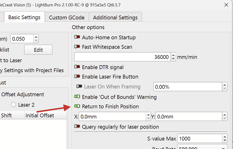

I can see that it’s a hassle having to refocus every time, but unfortunately, there’s nothing we can do about it.
The “Finish Position” can be controlled in the Device Settings here:

Are we using the same 2.1 RC-9?
Are these buttons missing on your side?
Were the AprilTags detected when you calibrated the lens?
Have you made sure the camera is in focus and the lighting is good?

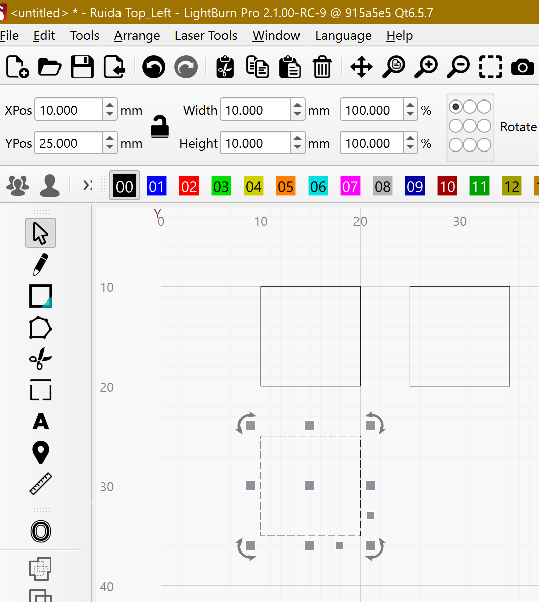

Also happens here.
It seems LightBurn is adding values to the edge distance but keeping them correct between objects:
Thanks for the feedback. It is important, I think, to determine that it is not a single, isolated incident that can also happen, like with the “Move” window not remembering the values ​​on a single (remote) computer.
I would like that the reporting of possible errors gets a “sequence number” with the status of its state, - registered, in processing and completed. Something like that is handled in “suggestions”. It will make the use of our feedback more efficient and contribute to an improved overview of reported errors / user experiences.
I did a few more tests by changing the Edge Buffer and Padding values and LightBurn add the values when calculating the distances to the edges. By the Edge Buffer tooltip this seems a bug, Is a new option and there isn´t any information I found about it.
Not quite, I’ve actually been using it for some time and therefore also stumbled upon the small error.
I always use it to place my first workpiece with 5x5mm from 0:0, it suits my machine and my needs well.

Yes April tags are well detected. They are printed black in a white paper.my camera is a fixed focus with a good setup and light is correct
Thank you for confirming.
Can you send us a picture of the engraved target tags? I’d like to confirm whether the contrast is good enough for them to be detected.
In the meantime, we’ve released a newer Release Candidate, RC-11.
I believe this also improved the tags detection.
Please download and install this version from here if you haven’t already.
It can help if you slightly vary the lighting conditions during the detection phase. You can even wave your hand in front of the camera until at least one of the tags in each corner is detected.
(In an upcoming version, it will also be possible to manually select the crosshairs, if the autodetection is not working, without the need to re-run the engraving.)
