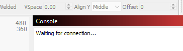

Bought an Acmer P1 S Pro second hand. Lightburn software will not connect find the unit. Have changed Com ports and upgraded to the latest version of Lightburn. Have tried all of the troubleshooting available online.
Please help.

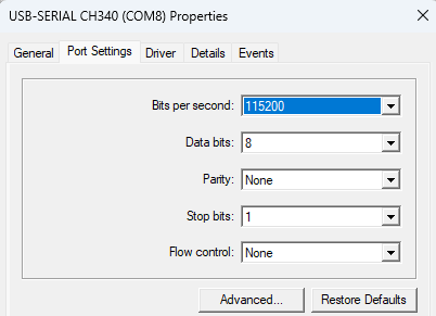

What is your baud rate set to in device settings?

What you are telling us is that it connects, but is not actually communicating. Our 3 suggestions above should get you going.

Thank you Dskall. Baud rate is at 115200 in both the laser burn device settings and in properties for the respective COM port in device manager. Still “Waiting for connection…” Is there anywhere else I should check?

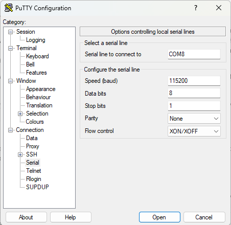

Additionally, ChatGPT advised to download putty.exe and after some commands, a black box would open. That was not the case. Instead an error sound played. Unsure if that tells you anything.
Anything else I could try?
Without telling me what you entered into putty, not much.

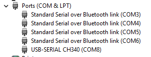

In Posting #8, I see a LOT of BT ports. With this window open in Device Manager, try deleting all the COM ports listed. Then unplug the laser and reboot windows. Let Windows rebuild them as needed when you power back up. Reopen the Device manager and then connect the laser. You should see only the CH340 entry. Screen shot it and post in a reply.

Additionally, I deleted all COM ports as instructed, rebooted Windows, then plugged the laser back in. The results are below. The BT Coms returned.

Unsure what you’re advising on this one. I apologize - I’m somewhat out of my depth here. The below is what I was advised to enter into putty by ChatGPT.

That last line is the one we are interested in, and it is the only USB-SERIAL. It also shows the CH340 driver is installed.
