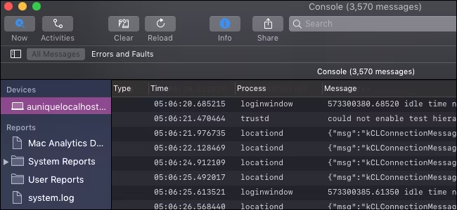

Long shot, but if you still have 1.6 installed maybe you could try this:
To view your Mac system logs, launch the Console app. You can launch it with Spotlight search by pressing Command+Space, typing “Console,” and then pressing Enter. You’ll also find it at Finder > Applications > Utilities > Console.
Will look something like this
Now launch lightburn again
Then in the console do a reload and see if the timestap can show any error lightburn related.
Could need to drill also into “user reports” zone.
Bit investigative, but if you have the time could help greatly.
