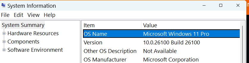

What version of Windows are you on? You can find this by pressing the windows key, typing ‘System Information’ and pressing enter.
Morning Colin. it is a windows 11 pro system. 10.0.26100 build 26100
