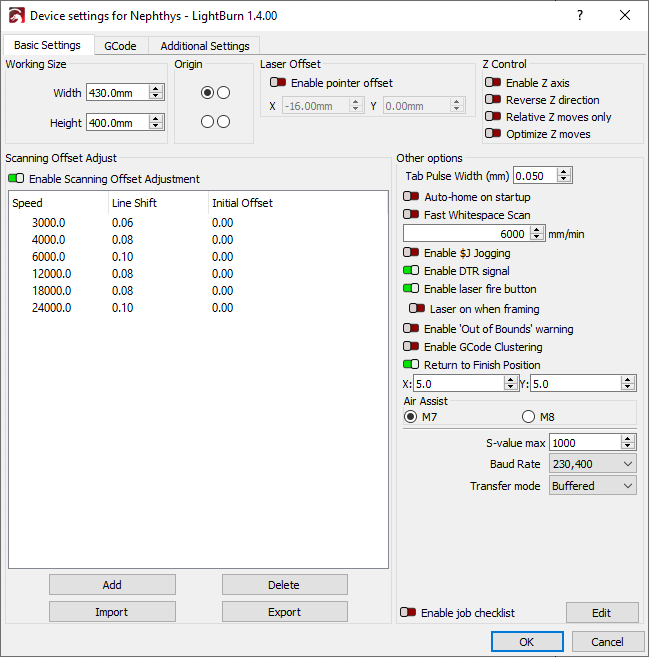

I’m testing Lightburn on my new Xtool. The Xtool run just fine with the XCS program. I’ve installed Lightburn and the additional file., several times. I’ve found older posts about the system being paused or busy. I’ve gone to the console to see if i get the welcome greeting. All I get are lines of scrolling lines of code. Any ideas

If you actually have a D1 Pro, your settings are wrong. Unless you have the 20W or 40W, your working size should be 430x400, uncheck laser offset if you’re not using the crosshair (should be X-16 if you are), there’s no Z control, so disable Z Control, uncheck auto home at startup, your S-Value should be 1000, and Baud should be 230,400.
All of these should have been set if you had imported the config file provided by XTool for Lightburn. Here’s my settings for my XTool D1 Pro 10W;
Edit: I suggest deleting that profile and following the Xtool guide;

Can you post screenshots of Edit->Device Settings again as well Console?
It seemed most likely that baud rate was the key reason for the garbled communication.

Your settings don’t match what would be expected if you had.
The console shows that LightBurn is now communicating with the xTool, however the controller is rebooting. The baud rate likely fixed the communication issue. The rebooting is typically related to a firmware issue. Not sure what the currently recommended firmware is to use on LightBurn, however.
I’d suggest fixing the device profile and trying again. It looks like to me you’re not using GRBL profile.
